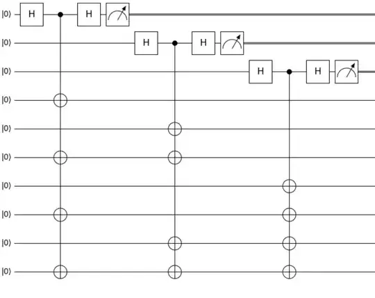

Here is a circuit that can create the desired state (similar ideas were discussed in this answer), if all mentioned measurements yield $|0\rangle$ state:
or in a more compact form (the circuits are constructed via quirk). The first three qubits are ancillary qubits and the rest are the qubits where $|0_L\rangle$ will be created if after the measurements all ancillary qubits are in the $|000\rangle$ state, otherwise one should repeat the procedure until the desired measurement result will be archived.
Let's go step by step. The circuit has three parts and in each step, we assume that the measured state of the ancillary is $|0\rangle$. The normalization factors are omitted.
- The state after measuring the first ancillary qubit in the $|0\rangle$ state: (measuring $XIXIXIX$ stabilizer)
$$|000\rangle \big( |0000000\rangle + |1010101\rangle \big)$$
- The state after measuring the second ancillary qubit in the $|0\rangle$ state: (measuring $IXXIIXX$ stabilizer)
$$|000\rangle \big( |0000000\rangle + |1010101\rangle + |0110011\rangle + |1100110\rangle\big)$$
- The state after measuring the third ancillary qubit in the $|0\rangle$ state: (measuring $IIIXXXX$ stabilizer)
$$|000\rangle |0_L\rangle = |000\rangle \big( |0000000\rangle + |1010101\rangle + |0110011\rangle + |1100110\rangle \\ |0001111\rangle + |1011010\rangle +|0111100\rangle + |1101001\rangle \big)$$
After disregarding the ancillary qubits that are in the $|000\rangle$ state we will have the desired $|0_L\rangle$ state. The probability that each measurement outcome will be $|0\rangle$ is $0.5$, thus the probability of creating the $|0_L\rangle$ state with this circuit is $0.125$. For Qiskit, one can implement the circuit mentioned above, then apply any algorithm or gate that is needed on the $|0_L\rangle$ state, and after the computation disregard all the results where ancillary qubits are not in the $|000\rangle$ state.

Very clear, but I don't understand the part about the probability of the outcome. I mean, on the three ancillary qubits you have two Hadamards thus, provided that $H\cdot H=I$, where $I$ is the identity, you should get $|0\rangle$ with probability 1, or am I missing something? – Hub One Jul 24 '20 at 16:58
1@HubOne, There is no place where we have $H \cdot H$, we always have control gates in the middle of Hadamards in this circuit. The probabilities can be seen from the link that I have shared for the equivalent circuit. Also, the probabilities can be obtained by calculating the state before, for example, the first measurement. – Davit Khachatryan Jul 24 '20 at 17:17
Of course, by simulating your circuit you're totally right, but I am still thinking I am missing something about the probabilistic part of your answer. I naively (and wrongly) think that, since the Hadamards are acting only on the control and the CNOT leaves unchanged the control, on that bit the CNOT acted like $I$ and thus we had $H\cdot H$. Can you show me why am I wrong? – Hub One Jul 25 '20 at 08:57
1@HubOne, let me try to explain with a simpler circuit. Can you find the state before the measurement of this two-qubit circuit? What is the probability of measuring $|0\rangle$ state? CNOT is a two qubit gate and it changes the state of both qubits. For example, if after CNOT we created an entangled state, that already means that the state of both qubits is changed (the control qubit's state inclusive...it will have some correlation with the target qubit). – Davit Khachatryan Jul 25 '20 at 09:19
In some cases, CNOT doesn't change the state of the control qubit, but it is not the general behavior of the CNOT gate. – Davit Khachatryan Jul 25 '20 at 09:24
1Is the state before the measurement $\frac{1}{\sqrt{2}}(|+\rangle |0\rangle + |-\rangle |1\rangle)$? However, I can see the problem now, it totally makes sense. Thank you – Hub One Jul 25 '20 at 09:32
@HubOne, you're welcome :). You are right. One question: can I change the title of your question to "How to create the logical $|0_L \rangle$ state for the Steane's 7-qubit code"? – Davit Khachatryan Jul 25 '20 at 09:37

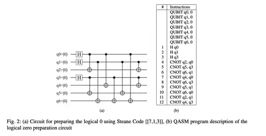

Here's a direct circuit to produce the logical $\bar{|0\rangle}$ state from https://arxiv.org/abs/1501.02524:
I'm not a qiskit expert, but in Cirq, I can check the superposition created by this:
import cirq
q = cirq.LineQubit.range(7)
state = cirq.Circuit(
cirq.H(q[0]),
cirq.H(q[1]),
cirq.H(q[3]),
cirq.CNOT(q[0], q[2]),
cirq.CNOT(q[3], q[5]),
cirq.CNOT(q[1], q[6]),
cirq.CNOT(q[0], q[4]),
cirq.CNOT(q[3], q[6]),
cirq.CNOT(q[1], q[5]),
cirq.CNOT(q[0], q[6]),
cirq.CNOT(q[1], q[2]),
cirq.CNOT(q[3], q[4]),
).final_state_vector(0, qubit_order=q)
print(cirq.dirac_notation(state))
results in
0.35|0000000⟩ + 0.35|0001111⟩ + 0.35|0110011⟩ + 0.35|0111100⟩ + 0.35|1010101⟩ + 0.35|1011010⟩ + 0.35|1100110⟩ + 0.35|1101001⟩
