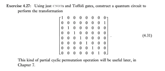

I'm working my way through one of the quantum circuits sections in Nielsen and Chuang and I'm struggling to get a feel for the basics of circuit construction. For example, one of the exercises is as follows: enter image description here
This exercise seems really simple on the surface, however I'm struggling to figure out how to go from a question posed like this to implementation. I can obviously write down the action in terms of the computational basis, but after this I get stuck.
I'm not so much looking for a specific solution to this exercise but rather using this as an instance of how to get into the correct frame of mind / use the correct procedures to solve problems with circuits.

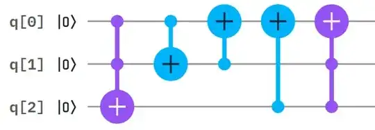

Here are the actions for the given transformation on the computational basis states:
$$|000\rangle \rightarrow |000\rangle \qquad |001\rangle \rightarrow |010\rangle \qquad |010\rangle \rightarrow |011\rangle \qquad |011\rangle \rightarrow |100\rangle \\ |100\rangle \rightarrow |101\rangle \qquad |101\rangle \rightarrow |110\rangle \qquad |110\rangle \rightarrow |111\rangle \qquad |111\rangle \rightarrow |001\rangle $$
Let's label the qubits in this format: $|q_2 q_1 q_0 \rangle$ (Qiskit's labeling). Here are some ideas. $|001\rangle \rightarrow |010\rangle$ and $ |010\rangle \rightarrow |011\rangle$ transformations can be done with CNOT(0, 1) and CNOT(1, 0) gates. $|011\rangle \rightarrow |100\rangle$ transformation can be done by adding Toffali(0, 1, 2) before the two CNOTs presented above and adding CNOT(2, 0) after the two CNOTs. $|110\rangle \rightarrow |111\rangle$ transformation can be done with Toffali(2, 1, 0). With this ideas we can construct the circuit (the ordering is important, but can be changed in some places):
For checking the correctness of the circuit we can try to give different inputs to the circuit and check the outputs or we can do matrix multiplications and see if the final matrix will be equal to the given matrix or we can use tools from Qiskit:
from qiskit import *
import qiskit.quantum_info as qi
circuit = QuantumCircuit(3)
circuit.ccx(0, 1, 2)
circuit.cx(0, 1)
circuit.cx(1, 0)
circuit.cx(2, 0)
circuit.ccx(2, 1, 0)
matrix = qi.Operator(circuit)
print(matrix.data)
The output:
[[1 0 0 0 0 0 0 0]
 [0 0 0 0 0 0 0 1]
 [0 1 0 0 0 0 0 0]
 [0 0 1 0 0 0 0 0]
 [0 0 0 1 0 0 0 0]
 [0 0 0 0 1 0 0 0]
 [0 0 0 0 0 1 0 0]
 [0 0 0 0 0 0 1 0]]
