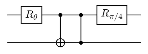

While trying to simplify a certain 2-qubit quantum circuit, I managed to get it down to this:
But by inspecting the corresponding two-qubit unitary directly, I can come up with the arguably simpler:
where the rotation operator "moved" to the first qubit. I am using the convention $ R_{\theta} := R_y(2\theta) = \begin{pmatrix} \cos\theta & -\sin\theta \\ \sin\theta & \cos\theta \end{pmatrix} $. The rotation $R_{\pi/4}$ is thus $=XH$.
How can I show that the two circuits are equivalent by "elementary" circuit identities, instead of just verifying that they amount to the same unitary? I tried many different simplifications without success.

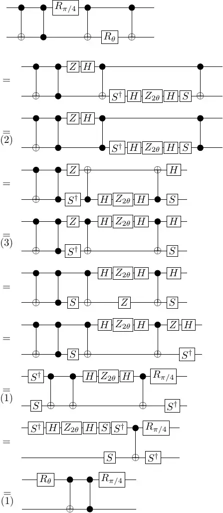

I am going to assume some usual transformations such as the involution of $H$ and CNOT. Rewriting the two gates $R$ with more standard gates, a possible derivation goes like this (details for equalities (1), (2) and (3) are given below):

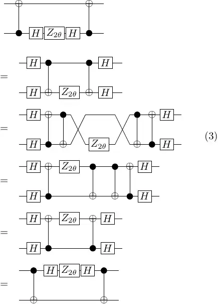

I used in particular the identity:
from which I also derived:
I also used:
A very powerful tool for doing this kind of graphical proof is the ZX-Calculus (https://arxiv.org/abs/0906.4725), which I actually used for reasoning on your problem here, before turning the answer in circuit form.

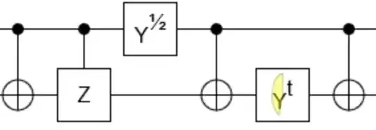

Why not make it even smaller?
One two qubit
Initial state:
Change rotation basis:
Phase the parity on the top bit instead of the bottom bit:
Apply XZ = iY to the adjacent CX CZ operations:
Move the middle CNOT leftward, changing its interaction basis from XZ to XY to ZY to ZY as it moves through the single qubit gates, resulting in it become a CY:
Cancel the adjacent CYs, then propagate the non-parameterized rotations rightward. This changes the basis of the rotation back to Y, and transforms the NOTC into a CY.
Cancel the two X rotations and you're done.
