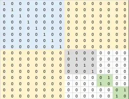

Matrix $CCNOT_{1,2 \rightarrow 4}$:
Matrix for Toffoli acting on fourth qubit and controlled by first and second qubit
