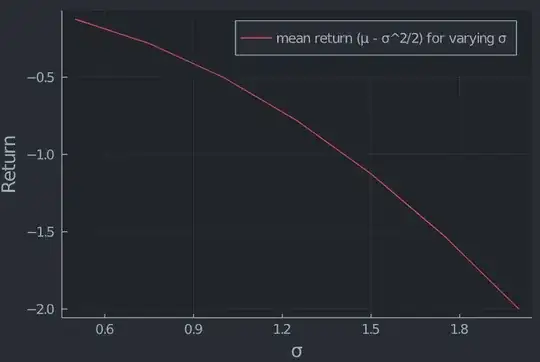

The continuously compounded rate of return over an interval $[0,t]$ is $$\frac{log(S_t)-log(S_0)}{t}.$$ Given the current stock price $S$, this rate follows the normal distribution $$\mathcal{N}((\mu -\sigma^2/2),\sigma^2/t). $$ In plain English, its logarithm is normally distributed with mean $(\mu -\sigma^2/2)$ and variance $\sigma^2/t$. As $t$ grows, variance decreases towards zero, whereas the mean of the rate of return does not depend on time $t$. However, the mean depends on volatility. The chart below shows this relationship for high vol ($t=1$).
The reason you get a negative value (for high IV) all pins down to this answer.

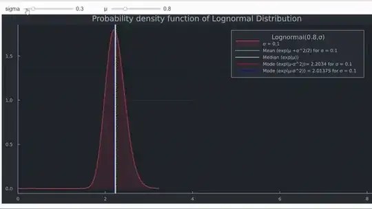

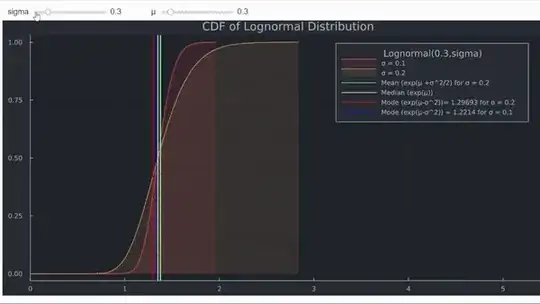

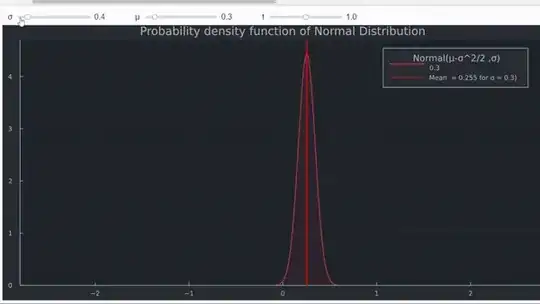

Intuitively, this indeed sounds a bit odd. In my opinion, it is best answered by looking at the probability density function (PDF) and cumulative density function (CDF). I ran some code in Julia to demo this:
  • The higher σ, the more the global maximum of the probability density function (the mode) shifts towards the lower bound of the lognormal distribution.
  • The cumulated distribution function (CDF) shows the increase in the probability of $S_T$ being very small.
  • Last but not least, the effect on the mean return can also be demonstrated by plotting the PDF of the normal distribution.
