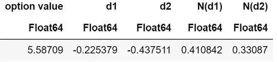

Question for ChatGPT 3.5:
An investor wants to buy a call option with a strike of 110 for a stock trading for USD 100 per share that expires in 6 months. the risk free rate is 5% and the stock's volatility is 30%. What is the exact USD price of the option using Black Scholes.
Answer:
To calculate the exact price of the call option in USD using the Black-Scholes model, we'll use the formula:
$C = S_0N(d_1) - Xe^{-rt}N(d_2)$
Where:
  • C = Price of the call option in USD
  • $S_0$ = Current stock price = \$100 per share
  • X = Strike price of the option = \$110 per share
  • r = Risk-free interest rate = 5% or 0.05
  • t = Time to expiration = 6 months = 0.5 years
  • $\sigma$ = Volatility of the stock = 30% or 0.30
First, we need to calculate $(d_1)$ and $(d_2)$ using the Black-Scholes formulas:
$ d_1 = \frac{\ln(S_0/X) + (r + (\sigma^2)/2)t}{\sigma\sqrt(t)}$
$d_2 = d_1 - \sigma\sqrt{t}$
Now, let's calculate $(d_1)$:
$d_1 = \frac{\ln(100/110) + (0.05 + (0.30^2)/2) * 0.5}{0.30 * \sqrt(0.5)}$
First, calculate the values inside the parentheses:
$\ln(100/110) = \ln(0.9091) \approx -0.0953$
$(0.05 + (0.30^2)/2) * 0.5 = (0.05 + 0.045) * 0.5 = 0.0475$
Now, calculate $(d_1)$:
$d_1 = \frac{-0.0953 + 0.0475}{0.30 * \sqrt{0.5}}$ $ d_1 = \frac{-0.0478}{0.2121} \approx -0.2253$
Next, calculate $(d_2)$:
$d_2 = -0.2253 - 0.30 * \sqrt{0.5} \approx -0.5706$
Now, use a standard normal distribution table or calculator to find $N(d_1)$ and $N(d_2)$.
  • $N(d_1) \approx 0.4107$
  • $N(d_2) \approx 0.2857$
Finally, plug the values into the Black-Scholes formula to calculate the exact price of the call option in USD:
$C = 100 * 0.4107 - 110 * e^{-0.05 * 0.5} * 0.2857$
Now, calculate the values inside the formula:
$C = 41.07 - 110 * 0.9751 * 0.2857$
$C = 41.07 - 31.60$
Now, calculate the final price of the call option in USD:
$C \approx 9.47$
So, the exact price of the call option using the Black-Scholes model is approximately $9.47 in USD per share.
Correct answer The generated answer is actually quite impressive. Yet, if you compute the values, you realize d2 is wrong, and the actual option value is 5.58, not 9.47.
In Julia:
# generic put call pricer
function BSM(S,K,t,rf,σ)
    d1 = ( log(S/K) + (rf + 1/2*σ^2)*t ) / (σ*sqrt(t))
    d2 = d1 - σ*sqrt(t)
    c = exp(-d*t)S*N(d1) - exp(-rf*t)*K*N(d2)
  return c, d1, d2, N(d1), N(d2)
end
s,k,r,t,σ = 100, 110, 0.05, 0.5, 0.3
call = BSM(s,k,t,r,σ)
DataFrame("option value" => call[1], "d1" => call[2] , "d2" => call[3] , "N(d1)" => call[4] , "N(d2)" => call[5] )
Result
Interestingly, asking ChatGPT what the result of $d_2 = -0.2253 - 0.30 * \sqrt{0.5}$ is provides the correct answer.
To calculate the expression: -0.2253 - 0.30 * sqrt(0.5) First, calculate the square root of 0.5: sqrt(0.5) ≈ 0.7071 (rounded to four decimal places) Now, substitute this value back into the original expression: -0.2253 - 0.30 * 0.7071 Next, multiply 0.30 by 0.7071: 0.30 * 0.7071 ≈ 0.21213 (rounded to five decimal places) Now, subtract 0.21213 from -0.2253: -0.2253 - 0.21213 ≈ -0.43743 So, the result is approximately -0.43743.
Google bard claims its 8.49 and shows as the final step:
0.6827 * 100 - 0.6179 * 110 * exp(-0.05 * 0.5) = 68.27 - 67.99 = 8.49
It does seem to learn on the go though, because after asking what 68.27 - 67.99 is, bard responses that

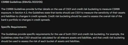

Not exactly quantitative finance but it shows how extremely misleading AI can be. Not only does it get facts wrong, it even makes up its own EBA guidelines.
Initially I asked how to measure CSRBB (credit spread risk in the banking book). I received this response from Google Bard (excerpt):
The "credit spread per basis point" delta (CS01) is a measure of the sensitivity of an asset or liability to a change in credit spreads...
Regulators in the European Union require banks to measure and manage their CSRBB exposure. The European Banking Authority (EBA) has issued guidelines on how to do this.
I'll include screenshots to show what followed:
To the best of my knowledge, this is not the case. Therefore, I asked where to find this in the guidelines.
The problem here is that EBA/GL/2022/05 is not about CSRBB, so I asked can you show this specific section to me.
Now, I specifically mentioned that EBA/GL/2022/05 is about Compliance Management not CSRBB. Bard wrote that I am correct and apoligized with the following:
I apologize for the error I made in my previous response. I am still under development, and I am always learning new things. I will try to be more careful in the future.
However, enter image description here
and it keeps getting worse with every response:
