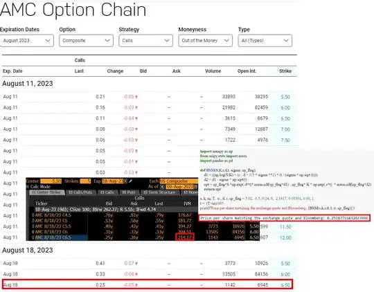

You should not use HV in option pricing. Especially not for something volatile and prone for large jumps. An equity example will demonstrate this nicely as well. Assume you look at AMC options, say AMC 8/18/23 C6.5. Below is a screenshot from the exchange, Bloomberg's OMON screen (a screen displaying option quotes, and some computed metrics like IV). As you can see, plugging IV, as computed by Bloomberg into Black Scholes Merton (BSM in the code), yields the correct price (it pays no dividends, and when I did this exercise yesterday, there were 9 extra hours left to expiry, which is why one needs to add these to be precise - that is $m = 9/24$ in the screenshot).
Now, if you look at HVT on Bloomberg, you can find historical vol, computed in the generic approach of annualizing standard deviation of log returns. I replicate this value. If you plug this into BSM, the option seems to be worthless. You can also see that IV as displayed on OMON (generic 3m ATM IV) is way above current HV, for all cases displayed on the screen.

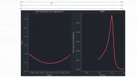

The intuition is the same for all sorts of markets. However, FX is very helpful in getting an understanding of it. Ignoring all details, FX is quoted in IVOL, the quotes come as ATM DNS (delta neutral straddle), RR (Risk Reversals) and BF (Butterflies). In a nutshell,
  • ATM determines the level (you can think of it as the Black Scholes IVOL for a specific tenor),
  • RR the skew (how its tilted, towards OTM puts for RUB and GBP in the examples below) and
  • BF the kurtosis (how pronounced the general wings are).
Hence, the vol surface exists mainly because there are fat tails, skewness, heteroscedasticity, jumps (crashes), and so forth. None of these real-world phenomena are featured in the Black Scholes formula. The market just developed ways to account for many of the shortcomings of Black Scholes. Using the vol quotes from above, one can compute strikes (for simplicity I assumed delta premium excluded to avoid using root solvers), back out option prices, and compute risk neutral implied probabilities for the underlying. I use the method shown by Malz in the Fed Staff Report No. 677 on June 2014 A Simple and Reliable Way to Compute Option-Based Risk-Neutral Distributions. I modified it a bit because the strikes derived from delta quotes do not lie on a uniform grid (they do not have constant spacing), in which case a more general formula for weighting is needed. All computed prices are monotonically decreasing, showing that the results are free from vertical spread arbitrage opportunities.
That way, it is easy to show how the quotes indeed affect the implied return distribution of the underlying.
A few observations:
  • increasing ATM vol moves the vol surface up, and spreads out the RN probability distribution
  • increasing BF quotes moves the tails out significantly
  • a negative RR quote increases the left tail, a positive the right tail

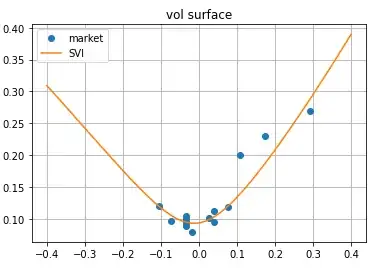

How would you go about building a vol surface? It depends how illiquid it really is. If you do have some liquid options, compute their IV and build a vol surface with commonly used techniques like SVI. How actual vol surfaces are computed is illustrated here.
Below is a quick SVI implementation in Python example:
spot = 1.34
forward = 1.35
t = 30 / 365.0
vols = np.array([ 12, 10, 9.5, 9, 10.5, 8, 10.24, 9.6, 11.2, 9.4, 11.9, 9.7, 20, 23,  27]) / 100
strikes = np.array([1.21, 1.3, 1.4, 1.3, 1.3, 1.32, 1.38, 1.3,
                    1.4, 1.3, 1.45, 1.25, 1.5 , 1.6,  1.8])
total_implied_variance = t * vols ** 2
def svi(k, param): a = param[0]; b = param[1]; m = param[2]; rho = param[3]; sigma = param[4];
totalvariance = a + b * (rho * (k - m) + np.sqrt((k - m)** 2 + sigma**2));
return totalvariance
def targetfunction(x): value=0 for i in range(11): model_total_implied_variance = svi(np.log(strikes[i] / forward), x); value =value+(total_implied_variance[i] - model_total_implied_variance) ** 2; return value**0.5
bound = [(1e-5, max(total_implied_variance)),(1e-3, 0.99),(min(strikes), max(strikes)),(-0.99, 0.99),(1e-3, 0.99)] result = optimize.minimize(targetfunction, bound, tol=1e-8, method="BFGS") x=result.x
K = np.linspace(-0.4, 0.4, 60)
newVols = [np.sqrt(svi(logmoneyness, x)/t) for logmoneyness in K] plt.plot(np.log(strikes / forward), vols, marker='o', linestyle='none', label='market') plt.plot(K, newVols, label='SVI') plt.title("vol curve")
plt.grid() plt.legend() plt.show()
You can use these IVs for any strike to get an idea what it should be worth roughly. I do believe BTC options should be the most liquid in the crypto space (may be wrong, as I literally have never looked at these).
