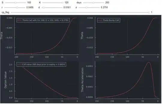

In the dataframe below, TV is the theoretical value of a call, theta is Black Scholes model theta, theta bumped is the finite difference theta, and theta acc is the theta acceleration, which becomes bigger and bigger the closer to expiration in this ATM example (S=K=100).
Since we already have a completely dataframe, we can make an interactive chart using a syntax similar to the one used here. You can clearly see that the shape from the textbook figure above is only valid for approximately ATM options.
Including acceleration, you see the following for an OTM Call: enter image description here
ITM Call enter image description here

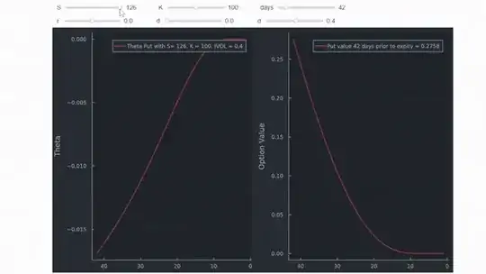

OTM Put (why theta can be positive here is explained in this answer)
and so forth...
