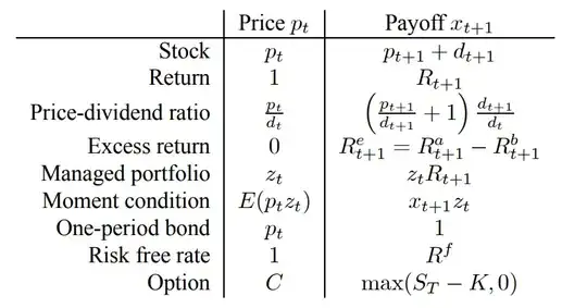

$\mathbb{E}[mR]=0$ is the Euler equation under $\mathbb{P}$ for excess returns.
In general, the Euler equation is $$P_t=\mathbb{E}_t[M_{t,t+1}X_{t+1}],$$ where $P_t$ is today's price, $M_{t,t+1}$ the pricing kernel and $X_{t+1}$ tomorrow's payoff. The expectation is conditional on information available at time $t$ and under the real world probability measure $\mathbb{P}$.
The Euler equation is often stated for returns rather than prices. Then, with $R_{t+1}=\frac{X_{t+1}}{P_t}$, we have $$1=\mathbb{E}_t[M_{t,t+1}R_{t+1}].$$
For excess returns ($R^e_{t+1}$), the price is zero by construction ($P_t=0$). The Euler equation is thus $$0=\mathbb{E}_t[M_{t,t+1}R^e_{t+1}].$$
Here are more examples from John Cochrane's fantastic book (chapter 1). enter image description here
