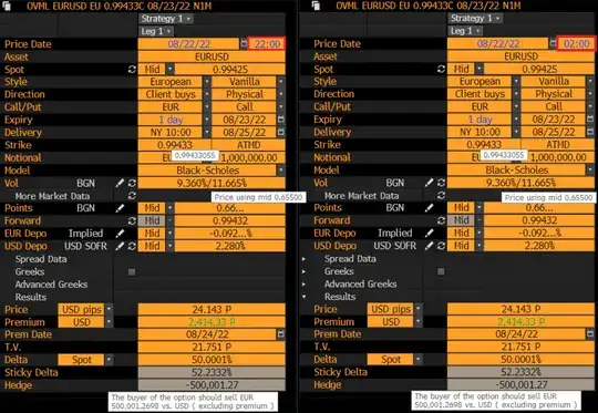

Bloomberg appears to be using 1. To verify this claim, let us consider a 1-day FX Option (as the "time" component would be most prominent). Below is a BBG screenshot showing the same option, but priced 20 hours apart (2am vs 10pm). Curiously, all results are exactly the same: enter image description here
We can easily replicate $K_{ATM}$ which is 0.99433055 (as per the screenshot). For this, we need to following:
  1. The Forward, which is 0.9943155 = 0.99425 + 0.655 / 10000 = Spot + Points.
  2. The ATM Vol, which is 10.5125% = (9.360% + 11.665%) / 2.
  3. The Time to Expiry, which is 0.002739726 = 1 / 365 = 1 day.
Putting it all together gives K_ATM = 0.9943155 * exp(0.5 * 0.105125^2 * 0.002739726) ≈ 0.99433055, which matches the ATM strike given by BBG exactly.
Any tau != 1 / 365 gives a strike that does not match anymore.

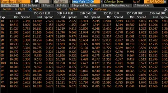

    Did you ask F1F1? The help desk should be suited to anser this. Also, looking at a pricing screen is unrelated to market convetion for quoting vol. You can look at OVDV to see the cut-off time for FX IVOL. Frequently it is 10am New York but obviously depends on the FX pair and market. Most accurate pricing will use the most accurate time to expiry. – AKdemy Aug 24 '22 at 06:11

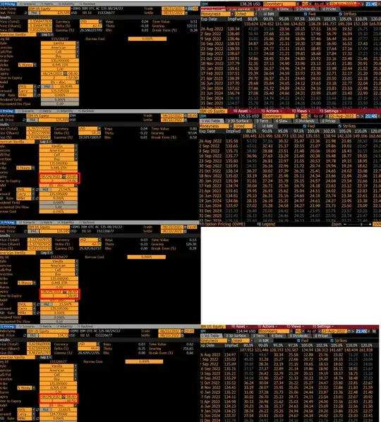

OVME (for equity) offers that setting, but by default it is off. OVML only has a setting to price the deal at the expiry date. Other than that, it uses only full days to eypiry. I can only guess the exact reason but likely it was a simple cost-benefit decision that was made when this was implemented. Bloomberg offers the aforementioned systems and golden copy intraday snapshots (BVAL) as premium systems.

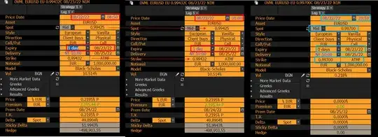

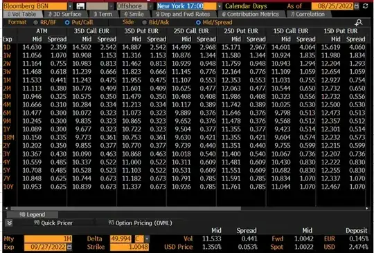

I think you are somewhat overcomplicating matters here. What you see for FX quotes (on Bloomberg OVML and OVDV) are only indicative over-the-counter (OTC) quotes, which in turn are by default going through the Bloomberg generic (BGN) algorithm. This is what you see on OVDV as well as OVML. These quotes have a specific cut-off. So they do imply an expiry time at say NY 10am.
If you now switch to an expiry at say NY 5pm you will get interpolated (hence white) values to account for the difference in time to expiry.
Either way, these quotes are not executable and simply indicative for what the market may quote, if you request a quote (RFQ). Since the cut-off is defined in the quote, market makers who contribute a quote will usually have that in mind. If you want to be certain, you will need to switch to a market maker of your choice and reach out to them, to get a clear answer if they accurately take this into account.

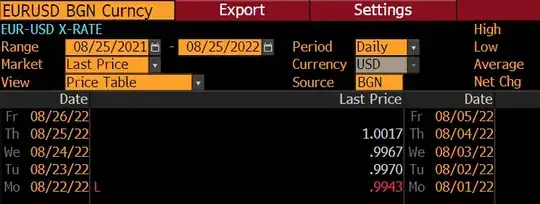

However, if you go back in time, Bloomberg (without additional premium services) will anyhow ONLY show you a single time (5pm NY) because intraday pricing is not available. That is why it does not matter what time you enter on OVML (as long as you are before 5pm NY).
My machine is currently set to GMT+2 which means that only after 11pm do I flip past 5pm NY. Therefore, at 11:59pm, it shows 0 days and a different exchange rate, which is the closing price according to BGN of the next day (HP is not showing all decimals, which is why you see 0.9943).

Turning to equity, if you look at OVDV and OVME, you also see OTC pricing. The IVOL is computed from listed options but OVME (unless you load it with a specific listed option ticker) will also be an OTC pricer. It uses the same logic, meaning you have only access to end of day prices. Even if you set OVME to use exact time to expiry, it will only change the $t$ in Black Scholes. Spot, IVOL and everything else is constant. So the only reason the computed price changes is that $t$ changes.
If your trade time goes back prior to the latest update of OVDV the day before, it flips to the previous day (even if it means over a weekend!). The reason OVDV has only specific set times is that it is quite complex to compute a full vol surface from listed option prices. The values do not match exactly because the tenor is from listed expiry dates and even with standard tenors you cannot go below 1W on BBG. Also, the strike is not ATM (which also ultimately depends on market data).
In any case, if your set time goes past the last available time at the previous day, you flip to the next days end of day surface (22nd of August here) and use that value for the entire day until you go past the time where the last available surface was created. After that, it flips over to the next days end of day value for IVOL.

  • As you can see in the OVDV screen it includes it - that is why the values in white are different and interpolated. Since it will ultimately depend on the market maker who provides the quotes, you would need to consult them and ask them for their exact details. Given they contribute for a cut-off of NY 10am for EURUSD, any quote that is received should reflect that. If the market maker cares about such detail for indicative quotes will be best answered by the market maker though. – AKdemy Aug 25 '22 at 09:40
