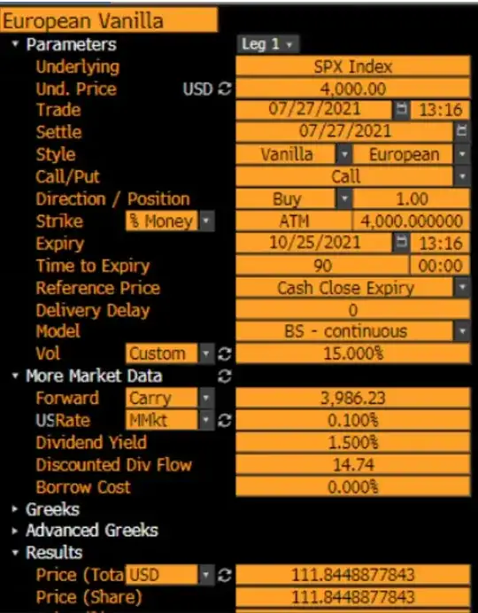

To make sure it works, we can compare our toy example to Bloomberg (I skipped some details like using continuous rates and dividends but the result is very close ($\Delta_{price} \approx 0.01$) either way, especially when looking at short maturity) enter image description here

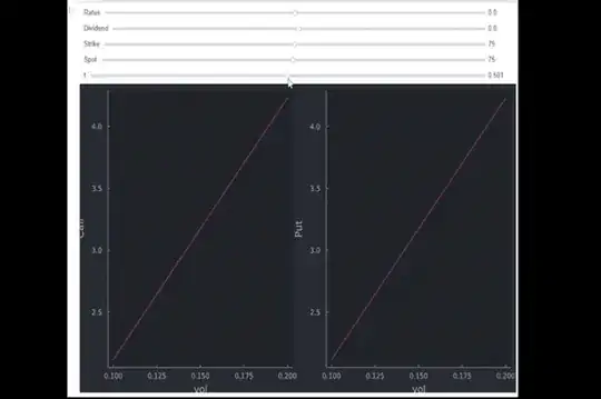

The short GIF below depicts the price of a call and put option for various vol levels. At the beginning $S=K=75$, $r=q=0$, and $t=0.5$ (half a year). The GIF shows what
  • happens if you reduce time (price declines): 0.001 corresponds to 36.5% of a full day; 1 is a full year)
  • increase spot (call up, put down): Ignoring $\Phi (d_{1})$ (often denoted as $N(d1)$) and $\Phi (d_{2})$ (also $N(d2)$), the basis for the Black-Scholes call formula is simply the current intrinsic value of the call option. So when the difference between $S$ and $K$ increases, the intrinsic value of the call option increases. With short time to maturity, as shown, the price is roughly just the difference between S and K.
  • increase strike (call down, put up): same as above, in reverse
  • decrease strike (call up, put down)
  • increase in dividends (call down, put up): both rates and divs can range from -30% to +30%
  • decrease in rates (call down, put up): As mentioned above, if $r>q$, the forward will be higher and you are better off holding a call vs a put (and vice versa as shown in the GIF). This also makes intuitive sense, because owning a call allows you to postpone the purchase, and hence you can still gain some interest on difference between the exercisable value and the cost of the option. For puts it is the opposite. Shorting outright (or selling the option immediately) would give you money to deposit into an interest baring account.
