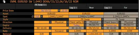

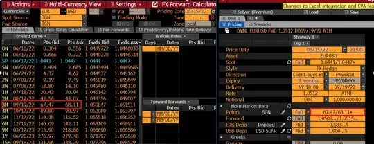

Longer tenors are classic forward outrights. They are an obligation to buy/sell at the agreed rate (the forward rate) at the date of expiry. That is why you simply add the forward bid to spot bid in these cases, whereas in the ON and TN case, you cross bid and ask because you have two opposite transactions.
Within Bloomberg, you can use OVML to see the difference between a foward (OVML FWD) and a swap (OVML SW). The standard forward has one leg (left hand side is FRD, right hand side OVML FWD). The asterisk (*) next to the side (ask for the 3m forward example) refers to the side of the market that the user is on (by default the client, not the bank / market maker). The generic rule is BBBB (bank buys base at bid), which means the bank is buying the base currency (CCY1 in a CCY1CCY2 quote, so EUR in EURUSD) at the bid. Insofar, if a client buys, the banks sells at ask. enter image description here

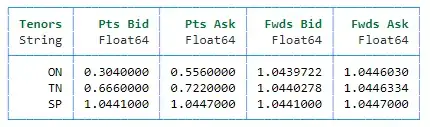

We can also quickly manually compute the values using the formulas above (I am using Julia).
import DataFrames, PrettyTables, Statistics # import relevant packages
# define market data from screenshot (only forward points and Spot)
SP_bid = 1.0441
SP_ask = 1.0447
ON_bid = 0.304
ON_ask = 0.556
TN_bid = 0.666
TN_ask = 0.722
define fwd_scale
fwd_scale = 10^-4
compute results according to formulas
ON_Ask_Outright = SP_ask - (TN_bid + ON_bid)fwd_scale TN_Bid_Outright = SP_bid - TN_askfwd_scale TN_Ask_Outright = SP_ask - TN_bidfwd_scale ON_Bid_Outright = SP_bid - (TN_ask + ON_ask)fwd_scale
create DataFrame
tenors = ["ON","TN","SP"] df = DataFrame(Tenors = tenors) df[!,"Pts Bid"]=[ON_bid, TN_bid, SP_bid] df[!,"Pts Ask"]=[ON_ask, TN_ask, SP_ask] df[!,"Fwds Bid"] = [ON_Bid_Outright, TN_Bid_Outright, SP_bid] df[!,"Fwds Ask"] = [ON_Ask_Outright, TN_Ask_Outright, SP_ask]
display results
PrettyTables.pretty_table(df, border_crayon = Crayons.crayon"blue", header_crayon = Crayons.crayon"bold green", formatters = ft_printf("%.7f", [2,3,4,5]))
The swap on the other hand has two legs (near and far) in opposite directions. enter image description here

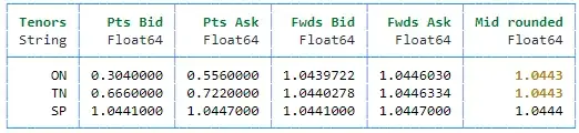

ATMF for ON and TN is identical due to OVML rounding values to 4 decimals and displaying MID as can be seen below.
ON_Mid_Outright_OVML = round(Statistics.mean([ON_Bid_Outright, ON_Ask_Outright]), digits = 4) # OVML displays ATMF rounded
TN_Mid_Outright_OVML = round(Statistics.mean([TN_Bid_Outright, TN_Ask_Outright]), digits = 4)
SP_Mid_Outright = round(Statistics.mean([SP_bid, SP_ask]), digits = 4)
df[!,"Mid rounded"] = [ON_Mid_Outright_OVML, TN_Mid_Outright_OVML , SP_Mid_Outright]
PrettyTables.pretty_table(df, border_crayon = Crayons.crayon"blue", header_crayon = Crayons.crayon"bold green", formatters = ft_printf("%.7f", [2,3,4,5]),highlighters = (hl_value(1.0443)))

  • Thank you very much. I was able to check the info in BBG that was quite useful. I do get that the longer tenors are classic forwards. What's the rationale behind the ON and TN swaps? For example in the ON in your image you sell 1M Euro today at the ON outright, and then tomorrow you buy the same 1M Euro but at the TN outright? – Aldo Shumway Jun 23 '22 at 05:29
  • The rational is probably well explained on Investopedia. The ATMF of 1.0443 that you see in the second screenshot is the MID for the TN quote (both legs are identical). – AKdemy Jun 23 '22 at 15:29
  • Thanks, learned a lot. I just have one question about the implied interest from today to the spot rate. Might post it later instead of the other one now that I have it more clear. – Aldo Shumway Jun 25 '22 at 22:54
  • By the way, don't you find it odd that BBG shows the 1.0443 for both the today leg and the tomorrow leg? I would expect that the Today leg ATMF was at the ON rate and the tomorrow leg at the TN rate, but it doesn't seem to be the case. – Aldo Shumway Jun 25 '22 at 22:55
