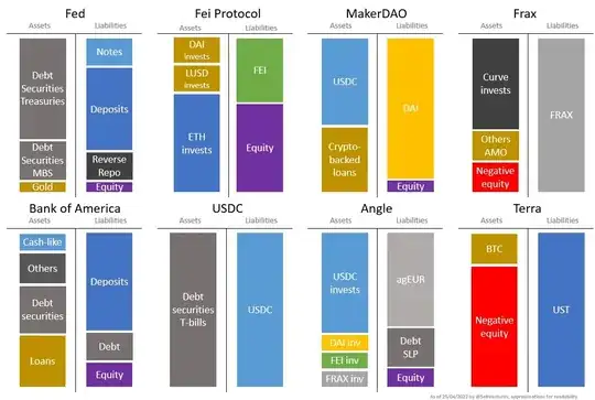

What comes to other stablecoins, here is a good image from SebVentures:

    I have a hard time visualizing how the concept of Luna equates to the concept of negative equity. Can you explain? Or is it just that Luna is fundamentally broken/worthless and therefore doesn't appear on the chart at all? – user253751 May 27 '22 at 11:00
  • It's a good question. I think the negative equity comes only play after the value of Luna has fallen so much that UST cannot be redeemed back to Luna "worth of a good price". If UST market cap > Luna market cap, it is realistic to say that it is not possible to redeem UST any more without a death spiral. However because UST can been always redeemed Luna (sans the Terra chain being halted) it is technically not so - you can keep printing more Luna tokens and try to sell them as long as Luna goes so low that you hit rounding errors and division by zero error. – Mikko Ohtamaa May 27 '22 at 12:52
