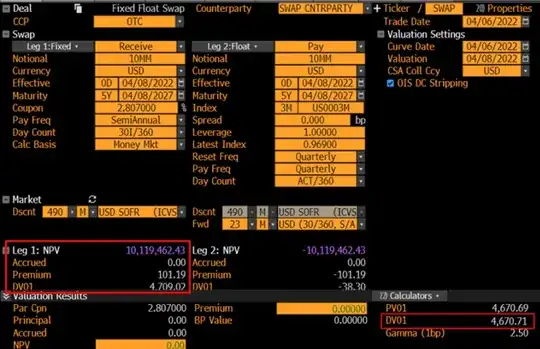

Contrary to your claims, Bloomberg bumps the swap curve AND the discount curve when computing DV01. Moreover, the principal exchange setting also has an impact.
Assuming a standard FXFL USD 3m Libor (same outcome for EUR or USD SOFR though), if you have Details – Additional Detail – principal exchange set to the default "Effective and Maturity" (or pretty much anything except Never), you get the DV01 on the fixed leg. enter image description here

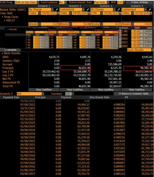

You can replicate DV01 in the scenario tab. Make sure you shift all curves - one scenario with -10bps, the other +10bps. enter image description here
The cashflows in the screenshot can be seen by clicking on view Cashflow. We can compute this in Python like so:
down_net_PE = (-24454.83,95497.01,-58783.90,65908.58,-77714.03,52265.44,-79520.45,54765.44,-69018.65,61277.39,-71510.19,59417.18,-61798.17,66713.08,-61215.31,67744.04,-56719.93,69103.54,-55678.05,70553.77)
up_net_PE = (-24442.50,90152.58,-63632.96,60762.28,-82381.46,47178.37,-84696.57,46072.23,-73548.68,56223.43,-75730.07,54690.73,-66002.74,61679.37,-65255.04,62888.32,-60684.76,64056.32,-59536.51,65625.37)
print(f'Principal Down shift 10bps = {round(sum(down_net_PE),2)}')
print(f'Principal Up shift 10bps = {round(sum(up_net_PE),2)}')
DV01_PE = (sum(down_net_PE) - sum(up_net_PE))/20 print(f'DV01_PE = {round(DV01_PE,2)}')
The result is:
If you set principal exchange to never, you get this picture, where DV01 largely moves to the float leg:
You can get all casfhlows:

Manually computing the DV01's results in: enter image description here
Which is identical to SWPM. The help page has a fairly lengthy explanation of the setting for Libor fixing. In a nutshell, the only difference is the first cashflow. enter image description here
