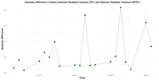

Looking at the R code you will notice that I have used the Realized Variance sampled daily (open-to-close) as my proxy and the corresponding QLIKE losses function. A graph is presented below, that shows the absolute difference in losses across days for two realized measures, Realized variance (RV) and Bipower Realized Variance (BPRV) on a 5-minute sampling frequency of AAPL:
lossdifference

If we utilize a Diebold-Mariano test (with pre-defined parameters given in the function) on our simple example, we get a $p$-value of $p=0.8981$ and therefore we fail to reject the null hypothesis of equal predictive power. Obviously, the results might look different for longer horizons and for different financial products. Doing the same pair-wise comparison for 20 different stocks (omitted from appendix code) the proportion of rejections is only 10%, implying that 2 out of the 20 stocks we failed to reject the null. In these two cases BPRV outperformed RV in terms of lower average loss, $d_{ij}$.
