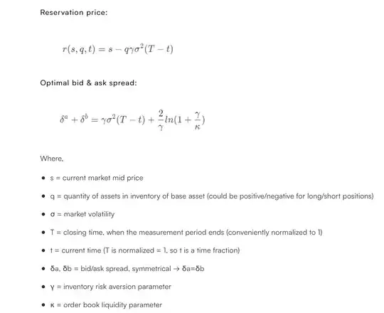

I am trying to implement Avellaneda & Stoikov (2006) model for HF market making on L2 orderbook data.
Most parameters are straight forward but I am struggling with the orderbook liquidity parameter (k). It's logic that the parameter should be larger for more liquid and smaller for less liquid markets, causing the spread to be wider in lower liquidity markets. enter image description here
But being in possession of L2 orderbook data I am wondering how to best compute the parameter, as the paper leaves this out of the discussion.
