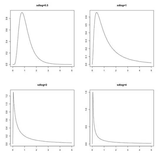

Your intuition is correct for a symmetric distribution. However, the log-normal distribution, as is assumed in the Black-Scholes model, is an asymmetric distribution. I have illustrated the effect of increasing the volatility, while holding everything else equal. The probability mass is squeezed towards zero.
The way I think about this in terms of intuition is that zero is an absorbing barrier for the process. This means that when the process hits zero, then the process "dies". If volatility goes towards infinity then the probability of hitting that absorbing barrier in the life of the option goes towards 1. Hence the price of a put option should be 1 and the price of a call should be zero.
