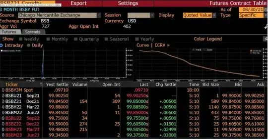

For example, BSBY-SOFR basis swaps already trade for a while now. The BSBY index is dynamic, it incorporates a credit-sensitive element, and it reflects the marginal funding cost for banks across five different tenors (overnight, one month, three months, six months, and 12 months).
CME also trades BSBY futures now. enter image description here
