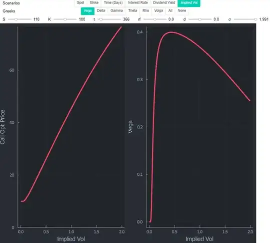

Vega is the option's price sensitivity to the volatility (i.e. IV). In the graph below, vega is shown to be a strictly positive function in volatility, which means that at any point in the graph (i.e. for any value of IV, irrespective of whether the option is OTM, ATM or ITM), the option price:
  • will increase in value if IV goes up (because Vega is positive)
  • will decrease in value if IV goes down (because Vega is positive: i.e. higher IV is "good" for option price, lower IV is "bad for option price)
Although we notice that as the IV goes up, Vega has diminishing returns.
It's simple in the end: Vega is strictly positive in Vol => higher Vol therefore always means higher option price => higher VIX means higher Vol => higher Vol (IV) means higher option price (you can argue either because Vega is strictly positive in IV, or simply because Option Price is scaled IV anyway).
  • all options have 1-year expiry, rates are set to 0.01 and spot is 100. The ITM call has strike 80, the ATM call has strike 100 and the OTM call has strike 120.

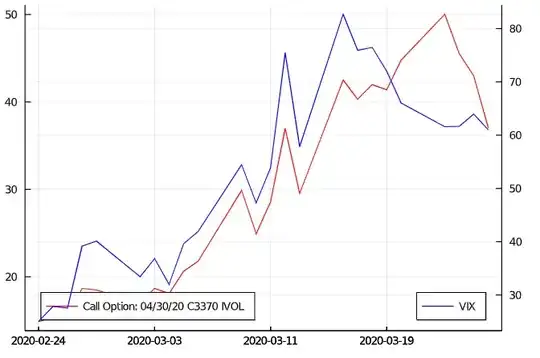

and for completeness sake, VIX against IVOL of the listed option. enter image description here

Below is a chart similar to @Jan Stuller that shows vega as a function of vol and also adds the call option price (this is in isolation, meaning all else equal). The relationship is clear here but not what usually will happen to Vega and prices.enter image description here
