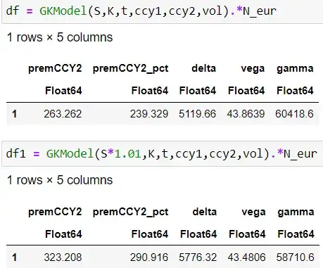

S = 1.1 # EURUSD for example K = 1.1 vol = 6/100 ccy1 = 0 ccy2 = 0 #(rd) t = 1 N_eur = 10_000
Delta is again unaffected by the value of spot whereas all other values (expressed in CCY2) naturally change.
Checking the change of the option price with respect to 1% change in spot shows the following (this time with actual notional in CCY1).
To hedge, one needs to sell an amount equal to delta in CCY1 to be delta hedged.
# sell EUR for USD is delta hedge
hedge = df.delta[1]*S
println("Selling $(round(df.delta[1],digits=4)) EUR at spot gives $(round(hedge, digits=4)) USD")
# mark to market after fx appreciated
mtm = hedge/(S*1.01)
println("New EUR value after EUR appreciated = $(round(mtm,digits=4))")
pnlHedge = mtm-df.delta[1]
println("The loss in the hedge is $(round(pnlHedge,digits=4)) ")
Checking against the actual change in CCY2 premium makes it look like the hedge was not particularly good.
However, remember, it is actually in CCY1 as opposed to CCY2. enter image description here
This not only matches closely the delta of 0.511 but also shows that the delta hedge was quite good indeed.
Looking at Gamma reveals that there must be an issue in terms of CCY of denomination. The change in delta is nowhere near what gamma suggests. As mentioned before, unit gamma works in a Taylor expansion. Trying this here shows it works quite well (simple comparing it to the actual change in value in CCY2). That is what @Kermittfrog was eluding to I think. However, it does not address the actual question of ccy of denomination (in my opinion).
To get gamma in ccy1, one needs to multiply by spot. Afterwards, delta plus gamma equals the new delta (approximately).
println(round(df.gamma[1]*S*0.01,digits=4)) #(to get gamma in notional ccy1)
println("The new delta will be close to delta old + gamma in EUR => $(round(df.delta[1],digits=4)) + $(round(df.gamma[1]*S*0.01,digits=4)) =  $(round(df.delta[1] + df.gamma[1]*S*0.01,digits=4))")
To conclude this rather lengthy post with, in my opinion, a very intuitive explanation; the reason delta is in CCY1 (or shares) is that you divide by spot (just like you do with premium in CCY2 to express it in CCY1). Similarly, for Gamma, looking at the derivative, $$\Gamma = \frac{\partial\Delta}{\partial S} = \frac{\partial^2 v_{ccy2}}{\partial S^2}$$ one can break this down to the dimensions of $\partial^2 v_{ccy2}$ which is CCY2, and $\partial S^2$ which is $(\frac{CCY2}{CCY1})^2$. Therefore, gamma is in $$\frac{CCY2}{(\frac{CCY2}{CCY1})^2}$$ This in turn is equal $$\frac{CCY1^2}{CCY2}$$ Rescaling by spot gives you Gamma in terms of CCY1 because $$\frac{CCY1^2}{CCY2}*\frac{CCY2}{CCY1} = CCY1$$ The code is in domestic vs foreign as opposed to CCY2 vs CCY1 but I think it should be clear that it is identical.
