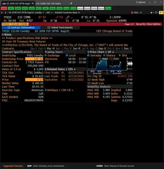

and here is the screenshot of BBG enter image description here

    I think your calculations are correct, at least for Black model. Do you know what is the model BBG uses? I was thinking that maybe it is cash gamma in BBG rather thatn ordinary gamma, but it isn't right either. BBG gamma looks like gamma(0.2829)∗futures(132.40625)∗0.01=0.37, but the formula for cash gamma is different. – emot Jul 01 '21 at 16:07
Short answer:
  • Gamma is computed differently;
  • price is quoted by the exchange in a way QuantLib does not compute
Long answer: BBG's DES page computes Gamma as 1% chg in underlying - there is also no flexibility with the DES page and frequently this is not the best calc they offer.
However you can load any listed option in their OTC pricers to get listed mode. TYQ1C 133.00 COMB Comdty OVME loads the ticker (next to the underlying). You compute it the "wrong" way around. This ticker is quoted in price (see OMON or HP)- so IVOL is a result, not an input. Price (share) will be color coded as it uses listed price.
In terms of Gamma - click on Settings (in OVME) - User Settings - Pricing - Greeks section - Gamma - set to 1 unit underly chg and you get ~27. On the same page, you may see fraction of days ticked. So expiry is in minutes not full days (and its only 21 left). I think the API fields (DES) do that too, but generally BBG is stronger with OV pricers and MARS than this FLDS API stuff (but is very close here, so should be fine).

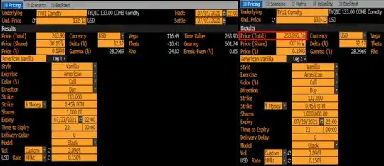

Quotation:
Shares displayed in OVME are the value of 1 point. The price quote is in points and fractions of points with par on the basis of 100 points. In your screenshot, the price is 0'17 and Tick Value is USD 15.625. Hence, what you see on OVME for the quoted price on that day is
  • Price (Share): 00'17 (what is quoted)
  • Price (Total): Price (Share)*Tick Value = 281.25
  • Price (%): Price (Total) per share / Underlying Price => $(281.25/1000)/132-13 =0.002124$
What qlib displays is actually neither of this. It is Price (Total) per share = $263.9/1000 = 0.2639$ in the screenshot below. I was manually overriding OVME to use your inputs. Hence price is no longer 00'17 but 00'16 7/8 (it now solves for price like in your example). The screenshot on the right uses a higher notional, so that you see the exact decimals - and how close the two are $236895.16/1000000=0.26389516$. enter image description here
Now essentially everything matches.
