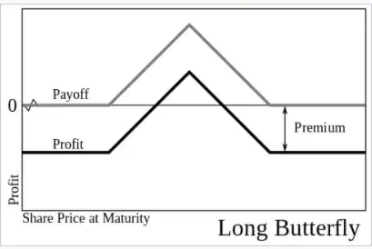

  • Thanks for detailed explain, but I am a bit confused now. So, no arbitrage actually means the value is positive today and in future right? From the graph I added above, consider the upper line, even today the zero is 0, the arbitrage opportunities in future still exist since its possible that V >0 in future? – will_www Feb 08 '21 at 17:15
  • @will_www as you rightly point out, the payoff of the butterfly (grey line) is positive. More specifically, you see it is null below $K-\Delta K$ and above $K+\Delta$, and strictly positive in between. Hence, if you are long a butterfly, there will be some scenarios where you receive 0, other where you will receive a positive sum. [cont'd] – Daneel Olivaw Feb 08 '21 at 17:29
  • [cont'd] @will_www suppose now the price of the butterfly was 0. Then you could be infinitely as many. This would amount to free money, that is arbitrage: if the price of the underlying ends up below $K-\Delta K$ or above $K+\Delta K$, you made zero PnL because you do not receive any payoff but anyway the butterfly cost you zero. But if you end up between those 2 values, then you are actually making a positive profit. – Daneel Olivaw Feb 08 '21 at 17:31
  • In conclusion, as you point out, arbitrage implies that, if the value is positive in the future (that is, non-negative always and at least strictly positive sometimes), then the value must be strictly positive today. Otherwise, you can make free money. – Daneel Olivaw Feb 08 '21 at 17:33
