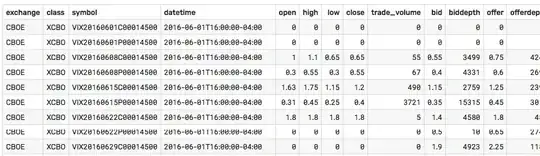

Once the records are in the database, you can query statistics with SQL:
SELECT exchange, class, symbol, datetime, open, high, low, closeprice AS close, voltoday AS trade_volume,
  bid, biddepth, offer, offerdepth, underlying_bid, underlying_offer, vwap, numcontracts AS opencontracts,
  custom_num_01 AS bid_size_1545, custom_num_02 AS bid_1545, custom_num_03 AS offer_size_1545, custom_num_04 AS offer_1545,
  CAST(CONCAT(SUBSTR(symbol, LENGTH(symbol)-7, 5), '.', SUBSTR(symbol, LENGTH(symbol)-2, 3))AS number) AS strike
FROM atsd_session_summary WHERE symbol LIKE 'VIX%'
  AND datetime BETWEEN '2016-06-01' AND '2016-06-02'
  AND strike BETWEEN underlying_bid*1.00 AND underlying_offer*1.05
ORDER BY entity.tags.symbol, datetime
Query results CBOE option end-of-day data
It helps to store reference data such as strike prices, expiration dates, underlying and root symbols, ISINs, CUSIPs, CIKs etc in the database as well, so that you can filter statistics using reference fields close to data, speeding up data retrieval.
  WHERE CAST(entity.tags.strike AS number) BETWEEN 10 and 15
