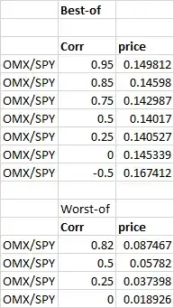

EDIT 2: I found the problem(s) and the prices seem to behave as expected now. For anyone interested there was a bug when normalizing the dependant ranom normal variates used in the simulation, so while they had the correct correlation one of them had a standard deviation of 1 and the other a standard deviation much greater than 1. Causing the price to not drop (and even increase) even as correlation increased. The parity relation suggested by @ir7 seems to hold now which gives me confident that all is well.
I'm valuing a rainbow option numerically with a monte-carlo simulation and I'm getting some unexpected results. The price of a best-of call option is decreasing in price as correlation up to a certain point where it starts to increase, contrary to my intuition. The worst-of option case is much more well behaved with being an increasing function of the correlation as expected. Since I'm valuing them in much the same way (just taking min(...) instead of max(...) in my code) I'm very confused as to what could be wrong, or is it possible for the price to behave in this way? If it's completely unreasonable, does anyone want to hazard a guess as to why my calculations might be breaking down as the correlation increases? The program is written in C++ so if anyone fluent in C++ wants to have a look at my code for something erroneous I'd be more than happy to post it.
EDIT 1: After troubleshooting a bit with the help of @ir7 it seems there's something off with my Monte Carlo simulation for several assets (the single asset case works fine). Posting (some of) my C++ code below for the simpler problem of valuing an out-performance option which as a closed form solution for him (and anyone else who wants to of course) to check out and give help. The caclulations again seem to break down once the correlation goes above ~0.5, see below image. enter image description hereIf there are some function calls used that you want me to explain or post the code for I'd be happy to do so, for now I'll try to keep it somewhat bare:

  • I agree that best of call price should be lower as correlation increase. It seems like that there is something hapenning when around $\rho = 0.5$. Can you check similar pattern happens when the correlation is below 0? – spar7453 Jul 04 '20 at 09:37
Intuitively, they should both be short correlation, that is the less correlated the assets are the higher the value of the worst of/best of option.

Edit2: You can look at the behaviour of the product packages I claim sandwich the rainbow, for various correlations. This could expose something quickly. Remember that those product packages need both MC prices (from the same loops you use for rainbows) and also have closed-form solutions (of course, vols are flat etc. in this debugging phase), so insert both versions in your comparisons.

  • Hey, thank you. In what I'm trying to model the worst-of option would pay the smallest increase rather than highest decline so I think your example is different from mine there. For your debugging advice, to clarify, you advice I price and compare: (vanilla call + outperformance_X-Y) ; (best-of call) ; (vanilla call + outperformance_Y-X) and compare for both analytical and MC valuations? Is that right? – Oscar Jul 04 '20 at 12:37
  • Yes. Any related payoff for which you know the prices under a non-MC method is worth putting in to make sure there is no structural problem with your framework. If you used object oriented design, you might already have the payoff class already segregated from the actual simulation. Once you are confident the framework works well for payoffs I used, you can then move confidently to subtler ones. – ir7 Jul 04 '20 at 12:42
  • And here I thought I was gonna relax this weekend. You are pretty much right on the mark, I do have both Black Schooled and vanilla Monte Carlo functions with segregated payoff classes. The vanilla MC class gives the same price as the black schooles class, as does the rainbow class function for the best-of call in the case where there is only 1 asset (as it should). I have also checked that the normal variates I create for the simulation do indeed have the expected correlations from the covariance matrix, so I've ruled out some structural issues. I will implement outperformance and see. – Oscar Jul 04 '20 at 12:49
