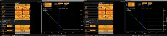

FX is quoted as CCY1CCY2 (e.g. EURUSD) where it shows the amount of CCY2 needed to buy/sell 1 unit of CCY1. In terms of options, the standard Black Scholes model (called Garman Kohlhagen in FX) has Notional in CCY1, but price in CCY2. The call and put position refers to CCY1. A EUR Call is equal to a USD Put and you do not swap the direction from long to short (that would be at the other side of the market).
Hence, if you want a Call on EUR you just need to buy a Call option. You can see in the screenshot below that a Long EUR Put is identical to a Long USD Call (or Long USD Put is equal to Long EUR Call).
