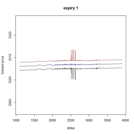

Here is an example to illustrate based on S&P500 options. Here I assumed a swap zero rate curve to use in the put-call parity formula. I interpolated this curve using cubic splines.
In red is $F^{ask}$, in black $F^{bid}$ and in blue the average of the two.
Here seems to work great expect for spikes, they must be less liquid points?
