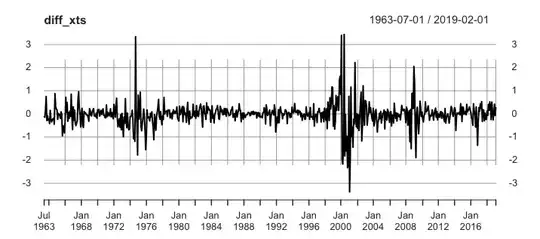

The following plot shows the difference of 3-factor SMB returns and 5-factor SMB returns:
So in fact, the 3-factor SMB return (on average) is just 0.03% per month (or about 0.36% per year) lower than the 5-factor SMB return, which is also less extreme distributed. The most differences arise in times of the "Dotcom-crisis", where the technology sector collapsed. However, this difference is not significant different from zero on average, based on a Newey/West corrected regression using a lag of six:
