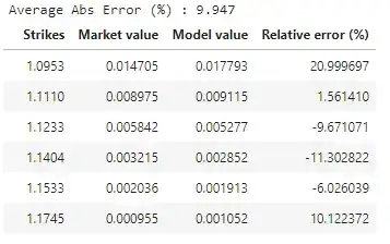

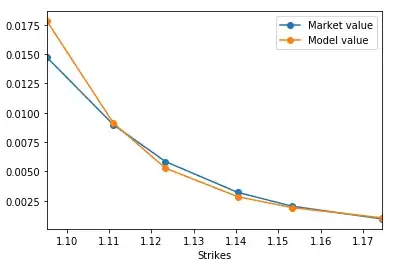

I put together a quick example using 6M options on the EURUSD (Should obviously be improved because the fit is not particularly good...).

theta, kappa, sigma, rho, v0 = model.params()
print(f"theta = {theta:.4f}, kappa = {kappa:.4f}, sigma = {sigma:.4f}, rho = {rho:.4f}, v0 = {v0:.4f}")
avg = 0.0
summary = []
for i, opt in enumerate(heston_helpers):
    err = (opt.modelValue()/opt.marketValue() - 1.0)
    summary.append((
        data[i][0], opt.marketValue(),
        opt.modelValue(),
        100.0*(opt.modelValue()/opt.marketValue() - 1.0)))
    avg += abs(err)
avg = avg*100.0/len(heston_helpers)
print("Average Abs Error (%%) : %5.3f" % (avg))
df = pd.DataFrame(
    summary,
    columns=["Strikes", "Market value", "Model value", "Relative error (%)"],
    index=['']*len(summary))
df.set_index('Strikes')[['Market value', 'Model value']].plot(marker='o')
