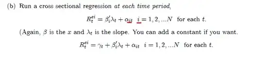

I am still asking myself what the pricing error terms in the Fama-MacBeth regression are.
Are they the intercept I regress across all assets in each month, once? Or are they the residuals of each asset in each month?
To clarify this I attach the picture of the formula I am referring to: enter image description here

Skoestlmeier says it is an intercept. But, from the above image (source: Cochrane) it seems to me, that alphas are the residuals for every asset i=1,...,N over each month t.
I would be very grateful for clarification.

It's all about the notation - so i try to be very precise now.
The Fama-MacBeth approach is a cross-sectional regression at each period of time: $$R_{t}^{ei}= \beta_{i}^{'}\lambda_t+a_{it}$$
where $R_{t}^{ei}$ is the excess-return of asset $i$ at time $t$ and $\beta_{i}^{'}$ denotes the estimated beta-factor of the stock. As stated in Cochrane (Asset Pricing, rev. edition, 2004, p. 235):
[...], $\beta$ are the right-hand variables, $\lambda$ are the regression coefficients, and the cross-sectional regression residuals $\alpha_i$ are the pricing errors.
You are right, that for $n$ assets over $T$ periods of time, this would result in a $T \times n$ matrix of pricing errors $\alpha_{it}$ (hence the double subscript).
What Fama/MacBeth (1976) suggest is, that we estimate $\lambda$ and $\alpha_i$ as the average of these cross-sectional regression estimates, i.e. $$\hat{\lambda} = \frac{1}{T} \sum_{t=1}^{T}{\hat{\lambda}}_{i}$$ $$\hat{a}_i = \frac{1}{T} \sum_{t=1}^{T}{\hat{a}}_{it}$$ ,i.e. both a $T \times 1$ vector.
As described in my answer here, we use the standard deviations of these (averaged) cross-sectional estimates to generate the sampling errors for these estimates.
