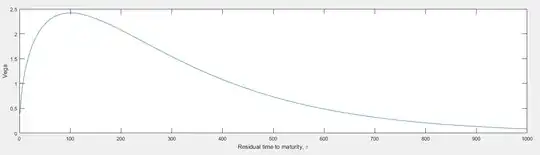

In your first question, you're looking for the sign of the derivative of Vega with respect to the residual maturity $\tau$. The closed-form expression of this Greek is given here under the name Veta. In our particular configuration we get $$ \text{Veta} = - S \phi(d_1) \sqrt{\tau} \left[ \frac{1 + d_1d_2}{2\tau} \right] $$ with $d_1 = \frac{1}{2}\sigma\sqrt{\tau}$ and $d_2 = -d_1$ such that $$ \text{Veta} = - S \phi(d_1) \frac{1}{2\sqrt{\tau}} \left[ 1 - \frac{1}{4}\sigma^2\tau \right] $$ since the prefactor has always the same sign, we see that a sign change occurs at $\tau = \frac{4}{\sigma^2}$. For typical levels of volatility -- say 20% -- this gives $\tau \approx 100Y$. This is easily confirmed by a quick graph (I've used $\sigma=0.2$, $r=q=0$, $S=K=1$). Since most traded instruments generally expire long before that time, this justifies the common belief of considering that $\text{Vega}$ is 'always' increasing.
