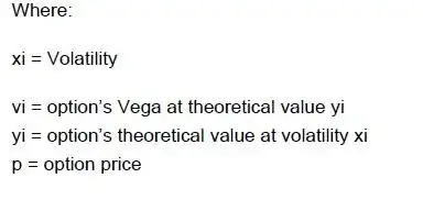

enter image description hereThink or swim has this thing where they have do a implied volatility of a stock. I have chatted with the TOS people but they aren't terribly helpful. Regardless they did send me two images of what they consider to the be formula. I'm not exactly sure if this is a good formula or something they just made up for me to go away. So I have attached the two screen shot.
Based on my poking around I would guess it's the weekly implied averages of the options one month out?
Update: I'm starting a bounty, cause I need to see a real life example from the US stock exchange, such as CMG, NFLX or whatever.
Does anybody have a clue where this formula came from, the implied volatility of stock formula? TOS formula is below, but I'm thinking it's weekly averages one month out? Thanks
Update: I'm starting a bounty, cause I need to see a real life example from the US stock exchange, such as CMG, NFLX or whatever. Although I believe the answer to be correct, I need a real life example to understand it.

  • I understand how to calculate Implied Volatility of an option. I have written that code in PHP. I clearly get that. However Think or Swim has a formula that calculates the IV of a stock. (see above) I want an example of how calculate the IV of a stock not an option. This is pretty rare formula and I can't seem to find an example. – Chad Jan 23 '18 at 17:05

What they gave you is Newton's formula.
If you have a function $f(x)$ then you can find the value $x_0$ such that $f(x_0) = 0$ by this method. It uses the derivative $f'$ which in your case is the vega.
Your function is: $$ f(x) = BS(x) - M $$ where $BS$ is the theoretical price with volatility $x$ and $M$ is the marketprice. Then $f'(x)$ is the derivative of the theoretical privce w.r.t. to the volatility - thus the vega. Note that
$$f(x_0) = 0 \Leftrightarrow BS(x_0) = M$$ for some volatility $x_0$.
The equation with the $\epsilon$ means that you stop if two consecutive values are close enough.

  • From best I can tell this looks like the answer and although I understand the BS model, my background is programming (python,php) any chance for a real life example. This looks like foreign programming language to me, that I can't decipher. – Chad Jan 11 '18 at 22:12
    This is mathematics.... The basis of lots of nice programming :) did you go through the Wikipedia article? Or Google the method? Try it in Excel? – Richi Wa Jan 12 '18 at 05:39
    Look at $f(x) = x^2-5$ which has the root at $\sqrt{5}$. Then start at $x = 10%$ and iteratively you approach the root following the formula that they provided ... Newton's formula. – Richi Wa Jan 12 '18 at 08:12
