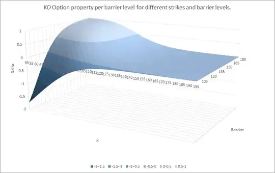

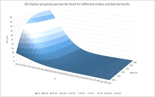

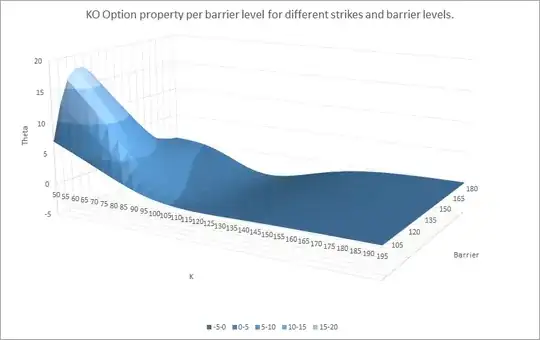

For example, here are the value,delta,gamma,vega,theta* for different strikes and barrier levels:
enter image description here enter image description here enter image description here enter image description here enter image description here
So you see, the relationship between all the different parameters is not so trivial. If you look at the back of each plot though (barrier at 180), these are approaching the vanilla values.
You also need to bear in mind that these are the greeks at a spot of 100 for each of the scenarios.

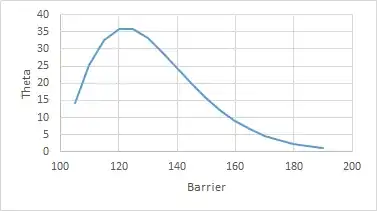

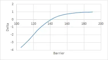

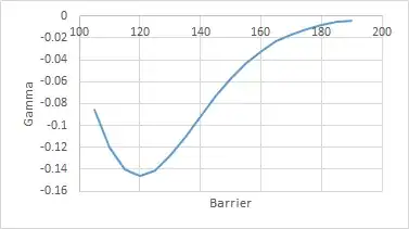

  1. Taking your example, why do i see them going negative when the barrier is closer to the spot price? My assumption was that these are generally all positive if I am long a call option. There are two effects going on at the same time. When the price goes up, you expect to make more money from your call option, but it has also become more likely to knock out, by merit of being closer to the barrier. One of these is positive, the other negative, and their magnitudes depend on how close to the strike we are, and how close to the barrier we are. Here are the same plots as above, but with a strike of zero (i.e. just a barrier) enter image description here enter image description here enter image description here enter image description here enter image description here Again we see the same theme as before, we the greeks tending towards those of a delta one product as the barrier is pushed farther away, as we would expect. But not that when the barrier is close, they are negative, since increasing the spot price makes the product more likely to knock out (delta), as we move closer to the barrier, the likelihood of knocking out increases more for the same increment as before (gamma), having a larger vol makes it more likely we will hit the barrier in any given day (vega), and as time goes on, if we have not hit the barrier already, then we now have fewer opportunities to do so, and so the value goes up (theta).

  • hello @will i understand your theta explanation but if the barrier is high it looks like a call with strike 0 for which the theta is negative so how come it changes sign ? thanks – TmSmth Dec 08 '20 at 15:09
