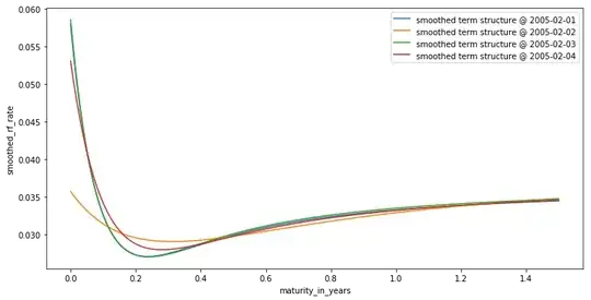

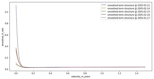

I'm adding here a plot of how of the term structure of the implied risk-free rate (that I have smoothed using a Nelson-Siegel fit but the behavior is present regardless of whether I smooth the curves or not) evolves as we approach the third Thursday 2005-02-17 :
Term structure of the implied risk-free rate when close to expiration
When we are a little far from that date, we get more coherent term structures :
Term structure of the implied risk-free rate when sufficiently far from expiration
