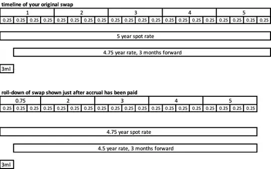

In your example, you're paying fixed 5 yr swap @ 2% and receiving 3ml @ 1.3% The 2% is the fixed rate in force for the life of the swap. The 1.3% rate will be reset in 3 months.
When we speak about swaps, the Libor leg is referred to as the "funding" leg.
Perhaps viewing the swap as a collateralized bond position would be helpful. We have a fixed bond at 2%, and we're going to finance it (repo) at 1.3%. Repo is our funding leg.
carry = forward rate - spot rate . carry = 4.75 rate, 3 months forward - 5 yr rate carry rate = -3 month rate
timeline diagram of two legs of swap
the only other way I can see the term "carry" being used with respect to an IRS is the cost to carry referring to the collateral posted against a swaps positions. If this is what you're looking for here, the carry rate won't necessarily be forward rate - spot rate. Rather you should look at the repo rates (i.e., SOFR) because LIBOR rates aren't used to calculate collateral due on swaps
