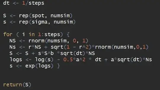

Trying to implement some monte carlo simulation for the first time. For the sabr model (http://www.javaquant.net/papers/managing_smile_risk.pdf), would this work?
Here, a = volatility of volatility, and s = volatility, and r = correlation of wiener processes.
If its ok, then why does it not produce the same results as the SABR formula does?
What I do is that I simulate S_T, then I compute max(S_T - K,0) for every simulation, and then calculate average. For some parameter choices, I get the same as SABR, but for others, I get the wrong number, even if I ramp up the sample and time steps.
So it my code wrong? Is the SABR formula wrong? Which technique produces correct results?

I can see two potential issues here:
Discretization Scheme
First, you should consider different simulation schemes. In the special case of constant volatility ($\alpha = 0$), the SABR model reduces to the CEV model. The basic Euler scheme that you employ for the spot process has been show to exhibit a significant bias for this process. See Lord (2014) and Chen et al. (2011) for an in depth-discussion and comparison of more advanced simulation schemes.
"SABR Formula"
I suppose that you refer to the second order expansion in Equation (2.17) of Hagan et. al (2002) as the "SABR Formula". As the name suggests this is only an approximation for the implied volatility. Furthermore, it is known to not be free of arbitrage (e.g. for very low strikes).
References
Lord, Roger (2014) "Fifty Shades of SABR Simulation," 10th Fixed Income Conference, Barcelona, available here
Chen, Bin, Cornelis W. Oosterlee and Hans van der Weide (2011) "Efficient Unbiased Simulation Scheme for the SABR Stochastic Volatility Model," Working Paper, TU Delft, available here
Hagan, Patrick S, Deep Kumar, Andrew S. Lesniewski and Diana E. Woodward (2002) "Managing Smile Risk," Wilmott Magazine

Although for a special case of normal SABR ($\beta=0$), there is an exact closed-form MC simulation scheme which does not require discretization in time. See my paper, Hyperbolic normal stochastic volatility model (arXiv | SSRN | DOI)
jChoi
  • 1,154
Perhaps you can give a few cases where your code does not reproduce the SABR formula.
Fix beta=1 and start with a=0. This should reduce to the Black-Scholes model. The code should match the BS formula. Then increase the vol-of-vol a, first with zero correlation and then changing it to some non-positive value, e.g. -0.7.
