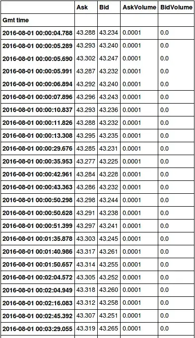

I have been given multiple sets of supposedly daily tick data (I say supposedly because I could not tell if it wasn't), that I would like to simplify for analysis. I have spent the last couple of hours trying to squeeze the necessary information out of google, but what I found is either too high level or the data in the examples were already pre-filtered/-aggregated.
If possible I would like to simplify the dataset so that I get a relatively accurate representation of inter-day change in ask and bid price.
The data I have currently looks like this (top rows of ~1.5 Million):

  • It seems you have to make the L1 order book from tick data. I'd check the volume column in the 2nd table and what o means in the first column. once you have that sorted, it should be not very difficult. – nimbus3000 Mar 28 '17 at 11:04
  • @nimbus3000, thanks for the comment. Could you maybe extend that a bit? – Moritz Mar 28 '17 at 11:07
  • if you mean that about the coding bit, I suggest you look online. You might find some implementation of the same. the idea is simple, if the new buy order is at a higher price compared to the existing buy order but lower than the current ask, you get a new level in the bid side of the order book. Works similarly on the sell side. For the volume bit, it must be an integer as long as it isnt normalized (which i've never seen). Plus a bid volume of 0 with logical bid price doesnt make a lot of sense – nimbus3000 Mar 28 '17 at 11:17
  • @nimbus3000, sorry that still doesn't make much sense to me :\ Any chance you could extend that into a full answer with maybe a mock calculation or recommend some sources that go into more detail and give more background? – Moritz Mar 28 '17 at 11:37
