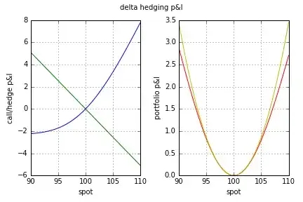

Assume you buy a plain vanilla call option at the price $V$ and the spot $S$. You immediately delta hedge buy selling $\partial V / \partial S$ units of the underlying asset.
The underlying asset now instantaneously jumps form $S$ to $S' = S + \Delta S$. The new value of the call option is $V'$. Your total p&l is
\begin{equation} \text{P&L} = V' - V - \frac{\partial V}{\partial S} \Delta S. \end{equation}
You can expand the change in the option price to the second order as
\begin{equation} V' = V + \frac{\partial V}{\partial S} \Delta S + \frac{1}{2} \frac{\partial^2 V}{\partial S^2} (\Delta S)^2 + \mathcal{O} \left( (\Delta S)^3 \right). \end{equation}
Substituting back yields
\begin{equation} \text{P&L} = \frac{1}{2} \frac{\partial^2 V}{\partial S^2} (\Delta S)^2 + \mathcal{O} \left( (\Delta S)^3 \right). \end{equation}
This is visualized in the below plots. They are based on $T = 1 / 12$, $K = 100$, $S = 100$, $r = 0\%$, $\sigma = 20\%$. The blue (green) line is the p&l of holding a long (short) position in the call option (underlying asset). The red line is the actual net portfolio p&l and the yellow one is the second order approximation of the latter using the gamma.
delta hedging p&l

  • Thanks. So the formula gives us the change in profit value due to an instant change in the spot price. If the change wasn't instant, I presume the formula doesn't hold since it doesn't include $\Theta$? ................................. Anyways. When the spot changes (not instantly, but after a day), and we reap some P&L, and then re-hedge our position so that we are still delta neutral, and then repeat that .... is this what you call "gamma trading"? Or is it just regular "delta hedging" done often? – Jaood Mar 12 '17 at 16:42
  • Yes - if the change wasn't instantaneous, you'd (generally) pay theta as the holder of the long position. This makes sense by looking at the right plot. The p&l is positive for any instantaneous spot move. We'd have a free lottery if at the same time the option wouldn't lose time value. This argument is a bit simplistic as it ignores financing cost. That is what I would call delta-hedging the position. Gamma trading usually involves a more proactive view that the theta is small (large) relative to the expected gain from holding a gamma long (short) position. – LocalVolatility Mar 12 '17 at 21:27
