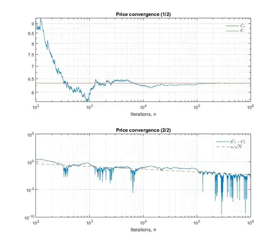

To get a graphical feel for the Monte Carlo rate of convergence, you'll need an exact price to compare your MC estimations to. For a European option and under the BS modelling framework, this price is given by the celebrated BS formula. Let's denote it by $C$. Similarly, let's assume you've picked a discretisation scheme for your SDE (although it's not needed for European contingent claims) and managed to simulate $N$ paths, hence $N$ values for the terminal asset price $S_T$: $$ S_T^{(n)},\ \forall n=1,\dots,N $$
  • Form a Monte Carlo estimator $\hat{C}_n$ of the true option price $C$ by using only $n$ paths out of the total $N$. $$ \hat{C}_n = \frac{1}{n} \sum_{i=1}^n e^{-rT} f(S_T^{(i)}) $$
  • Repeating this for all $n=1,\dots,N$ gets you a sequence of estimators $\{ \hat{C}_n \}_{n=1}^N$.
  • Plot the sequence $\{X_n\}_{n=1}^N$ where $X_n = \vert \hat{C}_n - C \vert$ in a log-log scale (x-axis = simulations used $n$, y-axis = $X_n$).
Due to CLT (as noted by @Behrouz Maleki), you should then observe that the "backbone" of your graph is a straight line of slope $-\frac{1}{2}$ as illustrated in the bottom subplot below (**)
(*) We can look only at variance because we know the mean is fine: MC estimators are unbiased (leaving aside discretisation-related bias as made explicit in @MJ73550's answer).
(**) You may want to skip the first simulations and start directly with $n=100$ to avoid polluting your graph.

  • Very Comprehensive +1 –  Aug 02 '16 at 09:05
  • ok, but where is the discretization error then? Even if you have a very large $N$, having a fixed number of steps will give just a constant error which is not decreased, so I am not sure how you end up showing only the Monte Carlo error when compare the estimate with an actual price? – Medan Aug 02 '16 at 12:51
  • Also, in the first plot $C_n$ gets closer to $C$ with increasing $n$, but in the second plot there are larger differences between the two from left to right. Are the legends correct? – Medan Aug 02 '16 at 12:53
  • @Medan The legends are correct: it is the scale which changes between the 2 subplots. The first one is the classic one. The second illustrates the convergence in $\sqrt{N}$ (which in log-log terms means a negative slope of $-1/2$). In the second subplot, notice how the error $\vert C_n - C \vert$ starts around $10^0$ and finishes around $ 10^{-2.5}$ with peaks at $10^{-9}$. – Quantuple Aug 02 '16 at 13:01
  • @Medan Monte Carlo is a generic method for calculating the expectation of a random variable. The convergence is in $N^{-1/2}$ by the CLT. Now, it seems like you're looking at a particular case, where for some reason you cannot sample the random variable of which you wish to compute the expectation (here $S_T$ direclty) which produces an additional discretisation bias. It is not clear from your OP that it is the discretisation bias you're interested in. Note that (1) You can sample directly $S_T$ wirh no bias under the BS assumptions, (2) In case of bias MJ73550's answer tells it all. – Quantuple Aug 02 '16 at 15:25
  • @Quantuple: I see, so you sampled the final value of the random variable, not the entire path. This makes sense, thanks. – Medan Aug 02 '16 at 15:29
  • @Quantuple: However, how exactly you plot the second chart? So you have $(C_n-C/\sigma sqrt{n}\approx N(0,1))$, then you take a $\log$ of that to get $\log(C_n-C)-1/2\log(\sigma n)$? I can't follow hot the second plot is derived from the first one based on legends. – Medan Aug 02 '16 at 15:37
  • @Medan First plot is the sequence $\hat {C}_n $, second is the sequence $X_n$ described in my post. First one is standard y-axis, logarithmic x-axis. The other one is logarithmic axes (or indeed you could plot $\ln (X_n) $ versus $\ln (n) $). – Quantuple Aug 02 '16 at 15:40
