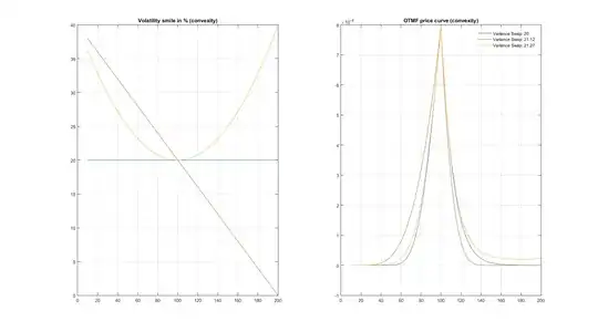

What you can say however is that, in the absence of jumps (i.e. in a pure diffusion framework, see here and here for further info), the fair variance strike $K_{var}$ at which a variance swap with notional $N$ and payoff
$$ N \times ( \sigma^2_{\text{realised}}(0,T) - K_{var} ) $$
should trade at the following par rate (or variance strike)
$$ K_{var} = \frac{2}{B(0,T)T} \left[ \int_0^{F(0,T)} \frac{P(K,T)}{K^2} dK + \int_{F(0,T)}^\infty \frac{C(K,T)}{K^2} dK \right] $$ where $T$ figures the contract's maturity date, $\sigma^2_{\text{realised}}(0,T)$ the variance of log-returns that will realise over the horizon $[0,T]$, $B(0,T)$ the discount factor, $P(K,T)$ and $C(K,T)$ European option prices with strike $K$ and maturity $T$ and $F(0,T)$ the forward price.
Thus, the price of a variance swap is simply a scaled integral of the OTMF price curve: $$ K_{var} \propto \int_0^\infty \frac{V(K,T)}{K^2} dK $$ $$ V(K,T) = \begin{cases} P(K,T) & \text{if } K < F(0,T) \\ C(K,T) & \text{otherwise} \end{cases} $$
Now, assume the following situation where, $S_0=100$, $r=q=0$ (no risk-neutral drift), $T=1$ along with 3 shapes of implied volatility smile at $T$: flat, pure skew, pure convexity. If you compute the fair variance strike $K_{var}$ under these different configurations, you will see that both negative skew and positive convexity have a positive impact and not specifically skew as you seem to indicate. See the simulations below where I've expressed the "variance price" as $\sqrt{K_{var}}\times 100$ similarly to what is done for volatility indices such as the VIX.

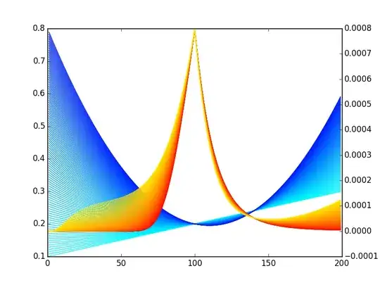

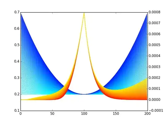

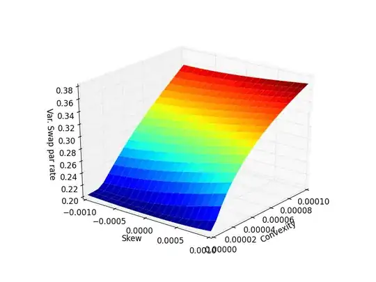

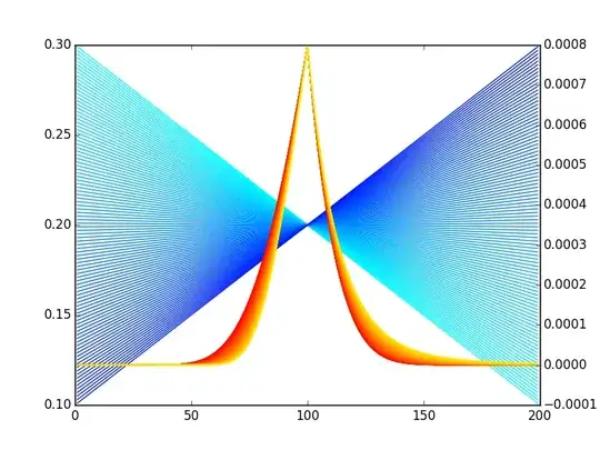

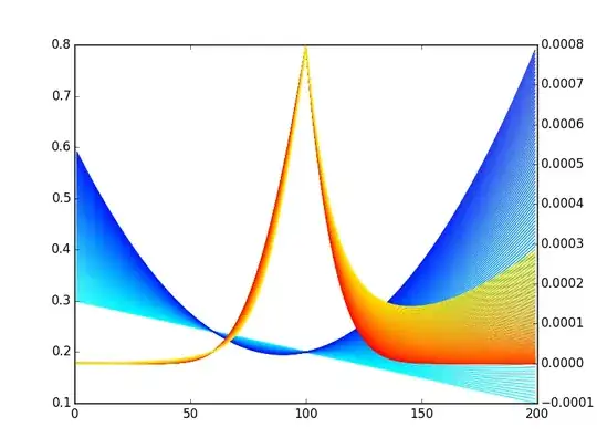

If you take Quantuple's stuff a little further, you can really see whether you're long skew. You can pretty easily see the dependence on convexity too (though it should be obvious that you're long convexity).
So first off, we need some smile parametrisation that lets us easily control convexity and skew. I just went with a made up one;
$$\mathrm{convexity} = \mathrm{C} = \left. \frac{\partial^2 \sigma}{\partial K^2} \right|_{K=F} \\ \mathrm{skew} = \mathrm{S} = \left. \frac{\partial \sigma}{\partial K} \right|_{K=F} \\ \sigma_{\mathrm{atm}} = \sigma(F) $$
which gives:
$$ \frac{1}{2} C (K-F)^2 + S(K-F) + \sigma_\mathrm{atm} $$
*Note that i understand this is not a proper smile, i'm just using it as a simple example.
Then if you look a pretty extreme range of smiles;
$$ -0.001 \leqslant \mathrm{S} \leqslant 0.001\\ 0 \leqslant \mathrm{C} \leqslant 0.0001\\ \sigma_\mathrm{atm} = 20\% $$
you get a bunch of images like Quantuple's in the other answer:
enter image description here enter image description here enter image description here enter image description here
But, we can do better:
So yes, you are long skew. But only a really tiny amount - you're much longer convexity.
