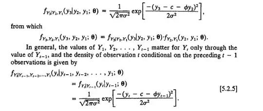

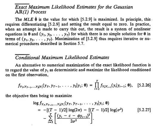

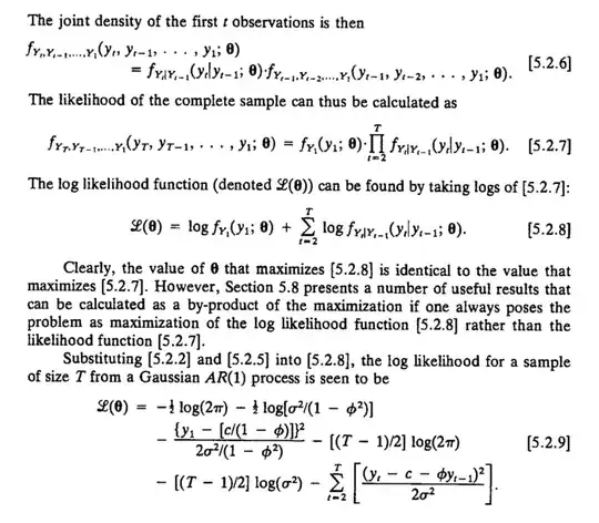

I found my answer no enough documented so this is an update. First the MLE method for a simple AR1 model is very well explained in the following page
See below,
(from : Hamilton, J. D. (1994). Time Series Analysis (1 edition). Princeton University Press. (page 122) ):
enter image description here enter image description here enter image description here
So as we see the Exact Log Likelihood [equation 5.2.9] differs from the Conditional Log likelihood [equation 5.2.27] in the sense that in the exact MLE we maximize the full likelihood (that is why we call it exact) whereas in the conditional version we truncate the likelihood by dropping the marginal : $-0.5 \log(2\pi) -0.5\log(\sigma^{2}/(1-\phi^{2}))- \frac{(y_{1}-(c/1-\phi))^2}{2\sigma^{2}/(1-\phi^2}$
This marginal replaces the expectation of $E(Y_{0}) = c+\phi Y_{-1} + \epsilon$ by the unconditonal mean $E(Y_{0}) = \frac{c}{1-\phi}$
