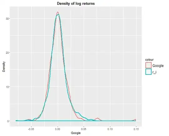

  • Thanks for your answer and sorry for mistakes. I made some corrections. I understand that I am not allowed to plug $\varepsilon^*$ instead of $\varepsilon$ and I would like to find a solution to this problem so I could run Monte Carlo assuming that $S_T/S_0 \sim NIG(\hat{\alpha}, \hat{\beta}, \hat{\mu}, \hat{\delta})$. So I need hints how to implement that. My code to simulate stock paths where $\varepsilon \sim N(0, 1)$ is correct as calculated option price converges to the BSM for a vanilla option. – tosik May 09 '16 at 10:33
  • @IvanovNikita, I've added details regarding how to simulate a NIG process. – Quantuple May 09 '16 at 12:08
  • Thanks again! So after doing this steps I will get set of variables $x_i$ which represent log returns, wright? To switch to the regular one I need to take exponent of them: $r_i = e^{x_i}$? – tosik May 09 '16 at 19:22
  • @IvanovNIkita, I've edited my answer because it seems like it wasn't clear enough. Following the steps described above will allow you to simulate paths of the global (log-)return process $R_t = \ln(S_t/S_0)$ (with iid NIG increments given by the periodic log-returns $r_{\delta t}$). To get back to classic stock price paths you need to write $S_t=S_0 \exp(R_t)$. From these price paths you can easily compute arithmetic returns if you want. – Quantuple May 09 '16 at 21:01
  • Yes, that's what I ment. If you have any references why to use the procces $x = \mu + \beta\sigma^2 +\sigma\varepsilon$ I would be thankful if you provide them – tosik May 10 '16 at 06:15
  • There's already an URL in my answer, see the part "Yet, because the NIG distribution is a special case of normal variance-mean mixture (... url here...). Or you can read the wikipedia definition of NIG. – Quantuple May 10 '16 at 06:55
  • Could you please see my edit – tosik May 10 '16 at 19:38
  • @IvanovNikita, Sorry for that: I had mixed up 2 different parametrisations of the Inverse Gaussian distribution. I have now fixed this (see my edits + reference for the method). Essentially you should draw $\sigma^2$ according to $IG(\delta/\gamma, \delta^2)$ and not what I mentioned before. Your plot of $r_i$ should now look exactly as your theoretical NIG pdf. I tested with a simple code in MATLAB and it works. – Quantuple May 11 '16 at 08:45
