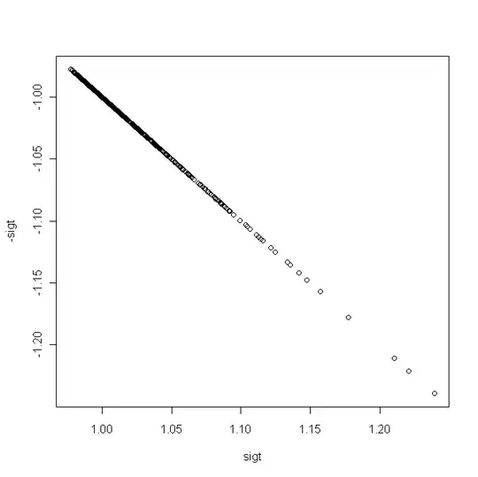

garch_model$fitted.values enter image description here

  • try plotting garch_model$fitted.values, I think you find your volatilities – SRKX Nov 14 '11 at 10:04
  • the problem is that I need to test it "programmatically" so how could I "write": "plot your time series of σ2t. If it is a straight line, the vol. is constant." in R? I can't do a visual check.. Maybe some values in the GARCH's returns help me to understand if it is constant or not? And what about GARCH(3,3) is it the standard? I also see 1,1. What to apply? A lot of thanks! – Dail Nov 14 '11 at 10:05
  • I added the plot of the fitted.values, what do you think? – Dail Nov 14 '11 at 10:09
  • I do not see you in chat, let me know – Dail Nov 14 '11 at 11:13
  • fitted.values has +/- sigt (why isn't clear to me). You want to plot the positive sigt versus some time index. Something like this: y <- arch_model$fitted.values[, 1] then x <- seq(1, length(y)) then plot(x, y). – Richard Herron Nov 14 '11 at 14:20
