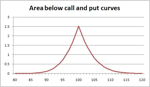

Simple explanation of VIX formula is that it is a square root of weighted sum of out of the money SPX options. If options are more expensive (implying that market is paying more for insurance from a major move) VIX will be higher, if options are cheap (implying that the market does not think that there will be a lot of movement in the SPX) VIX will be lower.
The weighting formula has a particular meaning - roughly corresponding to the area under the put and call curves.
I tried to provide intuitive explanation of VIX formula in http://onlyvix.blogspot.com/2011/09/intuitive-understanding-of-vix-formula.html
