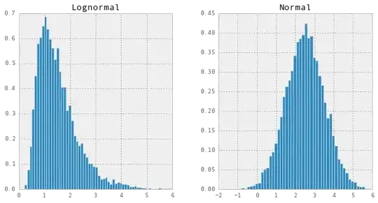

In theory, stock prices are lognormally distributed.
People usually prove lognormality by referring to positivity and right skewness of stock prices. Mathematically (or philosophically if you wish), lognormality follows from the following equation $\frac{S}{dS}={\mu}dt+{\sigma}dW$, which you may see a lot in quantitative finance ("random walk") or in physics ("brownian motion" or diffusion). If you solve this equation, you'll see that the price $S$ is lognormal indeed.
However, if you're not dealing with continuously compounding returns, especially with longer periods like weeks or years, you may not have a chance to observe continuous exponential compounding. Such a process can be very well described (or approximated if you wish) by geometric compounding.
Finally, back to your question. My advice for calculating risk adjusted measures in your case would be: unless you can prove, graphically or by statistical testing, that your weekly returns are lognormal, go with geometric averaging of simple percent changes. This will allow for (1) compounding and (2) better interpretability. Arithmetic averaging will give you wrong results when compounding. Lognormality will be an unnecessary complication in your case.
