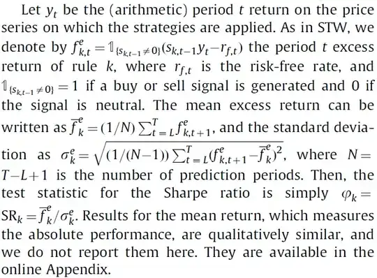

I'm trying to replicate the annualized Sharpe ratio of an buy-and-hold strategy for the Dow Jones Industrial Average index for a period consisting of multiple years. I got the daily DJIA (closing) price index (variable: "price") and the risk-free rate (given in a year percentage, variable: "rf").
The procedure I follow:
  • Compute daily log returns, by: log_returns = log(1+(price(t)/price(t-1)-1))
  • Compute daily log risk-free rates, by: log_rf = log(1+(rf/100))/252
  • Compute daily excess returns, by: excess_returns = log_returns-log_rf
  • Compute daily Sharpe ratio, by: daily_sharpe = mean(excess_returns)/std(excess_returns)
  • Compute annualized Sharpe ratio, by: annualized_sharpe = sqrt(252)*daily_sharpe
However the annualized Sharpe ratio doesn't correspond to the reported numbers. Am I missing a step/doing something wrong (with the logs?)?
Edit:
The calculation used by the paper (Bajgrowicz & Scaillet, December 2012): Sharpe ratio calculation

  • For example from 2-1-1997 up to 29-7-2011 they find a annualized Sharpe ratio of 0.12 and for 2-1-1987 up to 31-12-1996 a Sharpe ratio of 0.66 for the buy-and-hold strategy of the DJIA index (with daily Federal Funds Rates used as risk free rate, hence use the formula Log(1+rf/100)/252). The Excel file with the DJIA data they used (uploaded on Dropbox): DJIA Database – Wildman Oct 23 '15 at 08:37
