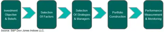

The following paper (and the references given within) focuses on the practical aspects of implementation of factor-based investing and gives an overarching framework for the more technical answers here:
Practical Considerations for Factor-Based Asset Allocation
by Kang, X. (Standard & Poor's), Ung, D. (Chartered Alternative Investment Analyst Association (CAIA); Global Association of Risk Professionals; CFA Institute), 2014
Abstract
Much has been written about the shortcomings of the traditional approach to asset allocation. Traditional asset allocation policies can typically be characterized by relatively static asset allocation and by diversification across asset class building blocks. As asset class returns are largely driven by common risk factors such as growth and inflation, traditional balanced portfolios can be poorly diversified, with a pro-cyclical growth bias that may lead to significant drawdowns and losses in the event of market turmoil. Against this backdrop, there has been an emerging shift, especially among institutional investors, toward more dynamic asset allocation, hinged on diversification across risk factors.
Exactly how risk factors should be included in the portfolio construction process is still a nascent area of research and is fiercely debated among practitioners. While there are numerous research papers that explore this topic, they tend to be theoretical, and it is for this reason that this paper has a stronger focus on the practical aspects of implementation. Rather than provide definitive answers here, we aim to share our reflections on this topic, following feedback from practitioners and discussions that took place in client roundtable events S&P Dow Jones Indices organized to promote dialogue with industry experts.
Especially helpful with regard to your question is the section "Implementation Issues to consider" p. 6 ff.:
Some important points for each step:
  • Investment objective and beliefs
    You have to embed your factor model into the general investment philosophy of your organization. Since general investment philosophies can be quite different (think "Yale model" vs. "Norwegian model" the objectives of implementing a factor strategy can be very different too.
  • Selection of factors
    This is the part which is addressed in pbr142's answer. Apart from the technicalities "factors should be chosen on the basis of how they can help achieve investment objectives while remaining within the confines of constraints, such as risk appetite, ESG policies and so on." And: "Investors may also benefit from examining the economic and investment rationale underpinning each of the candidate factor premia and ascertain whether their returns are derived from market inefficiencies, investor behavioral biases or from a rebalancing premium that is generated from the systematic selling of winners and purchasing losers. Depending on the source of the risk premia, investors may come to a different conclusion as to whether these risk premia are likely to persist in the future."
  • Selection of strategies and managers
    There are several trade-offs here. One is passive implementation (i.e. rule-based) vs. semiactive implementation. Another is investability vs. exposure. One key point here is that investors have to understand "factor/industry tilts their portfolios have, the return of the factors/industries over time and the macroeconomic factor to which they are most exposed." This is no trivial task and these exposures might not be what investors had expected at the outset of the strategy.
  • Portfolio construction
    This is dependent on size and execution of the strategy. The key word here is implementation costs. The more you move away from market-cap-weighted indices the more expensive it gets. These implementation costs are extremely difficult to predict!
  • Performance measurement and monitoring
    "Ongoing performance monitoring is indispensable in ensuring that the alternate beta strategies chosen meet investor expectations and objectives and, as noted previously, this would involve examining the portfolio’s overall factor exposure, sector biases and whether it has any secondary exposures to macroeconomic factors."
