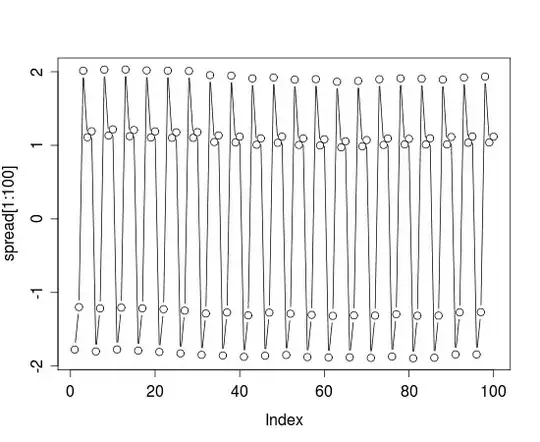

I get FX daily data from Oanda, do a simple linear regression to find the hedging ratios, and then use the Augmented DF test to test for the P-value of mean reversion in the spread.
When I run it I get this:
Minimum spread:  -1.894506
Maximum spread:  2.176735
P-Value:  0.03781909
Coeficients:
        GBP.USD     AUD.USD     USD.CAD     USD.CHF     NZD.USD
 0.59862816  0.48810239 -0.12900886  0.04337268  0.02713479
EUR.USD coefficient is 1.
When I plot the spread the first 100 days look like this:
Surely something must be wrong. The holy grail shouldn't be so easy to find.
Can someone help me find what is wrong?
I tried backtesting on Dukascopy with the above coefficients as lot sizes of a basket, but I run into loses. And the spread has a different order of magnitude in dukascopy. Why is that?

The main problem in your code is this line:
rowSums(coef(model) * frame[, -1])
I'm not sure exactly what is does, perhaps some matrix multiplication, but definitely not what you expect it to do. Try to replace it with manual multiplication
spread <- frame[,1] - (coef(model)[1]*frame[,2] + coef(model)[2]*frame[,3] + coef(model)[3]*frame[,4] + coef(model)[4]*frame[,5] + coef(model)[5]*frame[,6])
And holy grail will disappear
no more holy grail

@Sergey correctly identified the problem. The explanation is that coef(model) is a vector, frame is a data.frame, and element-by-element multiplication takes place in column-major order. The shorter vector (coef(model)) is recycled along the longer vector (each column in frame). For example:
frame <- data.frame(V1=1:5)
frame$V2 <- 2
frame$V3 <- 5
coef.model <- 1:3
frame * coef.model
#   V1 V2 V3
# 1  1  6 10
# 2  4  2 15
# 3  9  4  5
# 4  4  6 10
# 5 10  2 15
What you intended was something like this:
sweep(frame,2,coef.model,"*")
#   V1 V2 V3
# 1  1  4 15
# 2  2  4 15
# 3  3  4 15
# 4  4  4 15
# 5  5  4 15
