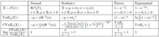

Where can I find more VaR and CVaR formulas for continuous distributions?
I collected a list here: enter image description here

Values of VaR are just the inverses of the cumulative distributions.
CVaR is not a very commonly used term, its more frequently used synonym is Expected Shortfall. See http://www.maths.manchester.ac.uk/~saralees/chap17.pdf for the list of Expected Shortfall values for more than 20 distributions.

  • I am looking for a list of $VaR$ and $CVaR$ together, because the notation for the distribution function differs sometimes? – emcor Oct 22 '14 at 14:57
  • @emcor: in the doc I have referenced, the author gives you the CDFs before deriving ESs. VaR = inverse of CDF! – Yulia V Oct 22 '14 at 15:04
  • I doubt that you can find any of the 20 inverses there yourself, except for maybe normal distribution. So its useless to give the cdf without inverse. – emcor Oct 22 '14 at 15:15
  • Well, in most cases cdfs are not in known in closed form, so you would have to inverse them numerically. For normal distribution, you usually have numerical methods to compute thw inverse of CDF. For most others, you will be inverting them numerically. – Yulia V Oct 22 '14 at 15:21
  • The question is on formulas for VaR and CVaR. – emcor Oct 22 '14 at 15:28

  • Thanks for your insight. However, I was looking for some exact formulas of VaR, CVaR for different parametric distributions just for research purposes... – emcor Oct 22 '14 at 19:37
    Other than the one posted by @YuliaV, I'm not aware of any papers like that off the top of my head. In practice, I just don't use the analytic formula often (really only for normal VaR). Not sure how common that is for others. – John Oct 22 '14 at 20:19

The paper "Calculating CVaR and bPOE for Common Probability Distributions With Application to Portfolio Optimization and Density Estimation" by Norton, Matthew; Khokhlov, Valentyn; Uryasev, Stan (2018) gives a large number of CVAR analytical formula with full proof.
Most of them can also be found on the Expected shortfall (aka CVAR) Wikipedia page.
