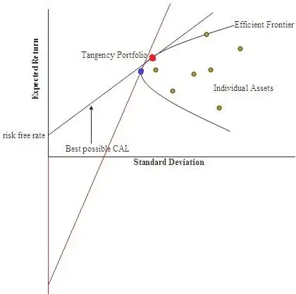

I would like to note one consequence of negative riskfree rate:
When the riskfree rate becomes more negative, the Market Portfolio (red) converges to the Global Minimum Variance Portfolio (blue).
The Market Portfolio does never equal the GMV Portfolio though, since the slope is infinite.
