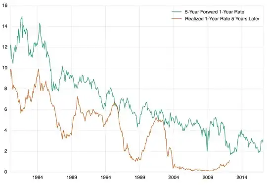

Performing such decomposition is actually not that easy and there are a few ways to do it. But a key observation is that forward rates frequently overestimate subsequently realized rates. This is known as the "forward rate bias" and is frequently quoted as evidence of positive bond risk premium. You can see this phenomenon quite clearly in the following chart, which plots the 5-year forward 1-year rate and actual realized 1-year rate 5-years later. I should emphasize that the pattern is not always true and in fact was quite untrue in the 1970s.
5-Year Forward 1-Year Rate and Realized 1-Year Rate 5-Years Later

  • Extra comment – please do not pick up the impression that bond risk premium has to be positive. In fact, it turned negative late 2011 and didn't become positive until very recently... – Helin Jun 18 '14 at 19:54
  • Thanks for your answer. If I understand correctly, when I am reading these texts, they are in fact using forward rates (ie implied from T securities) as forecasts of the interest rates (ie the interest rate used to discount to PV as well as the rate of the floater). Maybe I'm just reading bad articles but I find it strange that this is not clarified. – rex Jun 20 '14 at 08:54
  • @ArmenSafieh-Garabedian There are different schools of thoughts. One strategist I worked with believes these decompositions are meaningless, while I'm clearly on the other end of the spectrum. Over the past few years, equating forwards with expectations was actually quite safe, because there hasn't been a lot of risk premium priced in the curve, particularly at the front end. For a historical perspective, I dug around and found this research piece https://app.box.com/s/3udyrycv2wifcit7cbel. Also, I highly recommend "Understanding the Yield Curve," written by a former Salomon guy. – Helin Jun 20 '14 at 14:34
  • The image link is broken. – Luigi Ballabio Mar 08 '17 at 15:31
  • @LuigiBallabio Thanks I've replaced the image. – Helin Mar 13 '17 at 02:29
  • @Helin does this still hold? – Trajan Aug 23 '18 at 18:04
  • @Permian Yes; the current hiking cycle is not at all aggressive. – Helin Aug 23 '18 at 20:29
  • @Helin one question is whether the forward rate bias is an illusion based on the fact that rates have been rallying for 30yrs at an average of about 0.35% per year. Hence in a 5yr period you have 1.5% of unexpected rally which takes up most of the “bias”. I agree people can have different views. – dm63 Apr 02 '19 at 10:19
